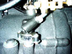

Guest Darth Maul Posted March 9, 2003 Posted March 9, 2003 i manage to get a new angle drive. it comes with a metal C bracket to hold the drive down so that it wont keep poppin out from the housing. but it doesnt comes with a place to mount the bracket on. (???) after replacing the new angle drive, we decided to spin the rear wheel... and to our horror we saw the new angle drive beginnin to pop out slowly from its housing. also when we spin the wheel backwards we can hear a sound coming out from the angle drive. every few anti clockwise theres a clicking sound. sounds like the gearing in there is winding itself up & up & then release... thus the clicking sound. After much testing and foolin around the cable route...dis is what we figure. the cable mounting at the top of the speedo is rather angle sensative. (Mike Stewart is right.) the speedo cable joint can be turn an angle here n there. so... in the end we just turn the speedo mountin and spin the wheel anti-clockwise until we found the best angle that doesnt click. kinda like lookin for the right radio frequency. then we just hold it in position w cable ties. also made a bottom mount for the C bracket... in case it will pop out again. at the moment the 'jumpin needle' is gone and i hope it will be ok from now on. will ride more this week to test it out.
