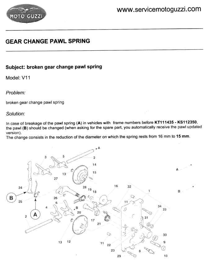

windchill Posted October 15, 2005 Posted October 15, 2005 Mr G's UK Technical bod has emphasised to my dealer the importance of fitting a 16mm diametre shaft!!!!! Yes, both the dealer principla himself, and the after sales manager checked this out!! Guzzi, at least in the UK are advising a 16 mm shaft!!!!! Scary. Anyway, we now have a multitude of springs (thanks all) and a selectin of shafts, including 15mm.
bigbikerrick Posted October 15, 2005 Posted October 15, 2005 Mr G's UK Technical bod has emphasised to my dealer the importance of fitting a 16mm diametre shaft!!!!! Yes, both the dealer principla himself, and the after sales manager checked this out!! Guzzi, at least in the UK are advising a 16 mm shaft!!!!! Scary. Anyway, we now have a multitude of springs (thanks all) and a selectin of shafts, including 15mm. 63310[/snapback] Hmmmm, 16mm? thats odd. I thought thats what caused the spring to bind and break I was going to tear mine apart and file it to 15mm IF its 16mm. Now what?
Baldini Posted October 15, 2005 Posted October 15, 2005 Someone's taking the piss. This is a copy of Moto Guzzi service bulletin relating to pawl spring.

belfastguzzi Posted October 15, 2005 Posted October 15, 2005 Hmmmm, 16mm? thats odd. I thought thats what caused the spring to bind and break I was going to tear mine apart and file it to 15mm IF its 16mm. Now what? 63314[/snapback] As there is now a wider coil spring, apparently, the explanation could be that newer bikes now come with a 16mm boss and a bigger spring coil. The bulletin that Baldini posted had specific range numbers. Maybe bikes after that should be 16mm? Why that should be – who knows ? Could be a case of remedying a mistake by making it the norm, instead of going back to original spec. Anyway, it's mostly around 2002 that the problems occured, wasn't it? There's a date list / poll somewhere. If anyone with a newer model (2004/05?) is checking their's, best to be aware of the possibility that 16mm might be the correct size. Only way to know would be to physically check the operation of the two parts together.

windchill Posted October 16, 2005 Posted October 16, 2005 Thanks for the service sheet, very handy. Any chance of a higher res version by e-mail? The "16mm" advice/instructiin is what my dealer was told to to by MG in the UK. Anyway, will be a ble to report back tomorrow, after measuring all the bits, and taking thier part numbers.
Baldini Posted October 16, 2005 Posted October 16, 2005 .... Any chance of a higher res version by e-mail?... Windchill - Sure, I'll do it this evening. Does your frame # fall outside the #'s specified in the bulletin. I would imagine those #'s just cover a production period? KB
Baldini Posted October 16, 2005 Posted October 16, 2005 Windchill - I emailed you the bulletin. If it doesn't come thu let me know - not sure if I got your email details right. KB
Baldini Posted October 17, 2005 Posted October 17, 2005 ...the explanation could be that newer bikes now come with a 16mm boss and a bigger spring coil. The bulletin that Baldini posted had specific range numbers. Maybe bikes after that should be 16mm?.... but...if later bikes did have 16mm boss & larger spring, why not just fit newer, bigger spring to the failed bikes? Why retro-fit 15mm boss & spring? KB
windchill Posted October 17, 2005 Posted October 17, 2005 MG spring and 15mm boss seem made for each other!!! The only further "alteration" which we feel will help matters is to "dress" or smooth off the rough edges of the steel "quadrant" against which the peg of the spring sits. On mine, the finish is so rough that there is potential for drag to exacerbate the binding effect. All going back together now.
Baldini Posted October 17, 2005 Posted October 17, 2005 ....All going back together now.... Did MGUK have any comment re discrepency between MG service bulletin & their advice to your dealer re 16mm boss? KB
