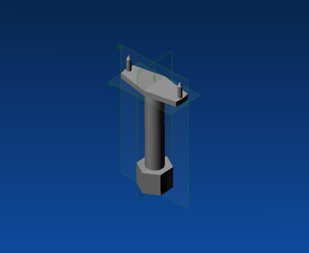

Guest Nogbad Posted September 24, 2005 Posted September 24, 2005 This thread made me think. It occurs to me that it isn't getting a new easy spinning filter ON through the pan hole that is the difficulty, it's getting the old stuck one out. What is needed is a screwdriver than can be inserted axially to pierce and twist off the old can. So, I have come up with the tool illustrated below. It should be used in conjunction with a hammer, followed by a socket and bar. Don't use it for putting the new one in.

Guest Nogbad Posted September 24, 2005 Posted September 24, 2005 So, shall I refine the CAD model and get some made? Who would be interested in buying my "Guzzi Keyhole Surgeon Filter Vandalizer"? I think I will add a protective sleeve to centralise it in the "keyhole" so you get a straight pierce.
Guest ratchethack Posted September 24, 2005 Posted September 24, 2005 Who would be interested in buying my "Guzzi Keyhole Surgeon Filter Vandalizer"? errr......Well, now that you've developed the idea into 3D Nog, I can just make one up in my shop - But thanks for taking the idea from Neanderthal technology all the way up to the Iron Age. OTOH, your drawing has a distinct Medeival look, so maybe it's actually fairly high-tech...
