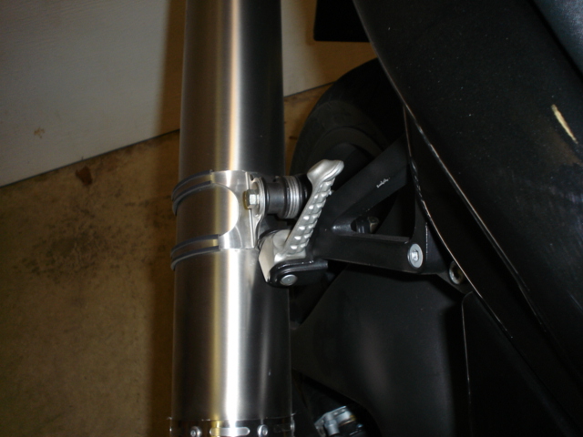

rocketman Posted October 23, 2005 Share Posted October 23, 2005 I had trouble mounting my mg ti cans. When I put the hangers on in the direction I thought they should go, hangers pointing forward, nothing fit right. The crossover was too long, the cans wouldn't clear the rear foot pegs worth a crap, and the oval band was way forward on the cans. So I pointed the hangers toward the back. This is done by how you mount that stupid triangular adapter (Really disappoint with the hangers, the stock ones are much nicer). This way the oval bands are futher back on the cans (little more than 1/3 of the way up the can). Also had to add 3/4 to 1 inch spacer to clear the rear foot pegs. I used the rubber inserts from the original hangers and three washers. The instuctions that ship with the cans are poor. I have pictures but I can't figure out how to post them. Rocketman Link to comment Share on other sites More sharing options...

rocketman Posted October 24, 2005 Share Posted October 24, 2005 Here are the pictures showing how I mounted my mg ti cans. Rocketman Link to comment Share on other sites More sharing options...

bigbikerrick Posted October 24, 2005 Share Posted October 24, 2005 Here are the pictures showing how I mounted my mg ti cans. Rocketman 64292[/snapback] The way you mounted the cans looks good, but does it make the footpeg position more uncomfortable if you carry a passenger,as the pegs are higher and further back? Link to comment Share on other sites More sharing options...
rocketman Posted October 24, 2005 Share Posted October 24, 2005 Bigbikerrick, I'm sure it does. Haven't taken a passenger since I mounted them. Really, I don't think there is a whole lot of difference (both look terrible uncomfortable). I just couldn't get em to work at all the other way. Maybe I wasn't patient enough. Too jazzed about getting them on so I could here them. Might have to get a second bike for the two up thing. Do you have the ti cans? How comfortable is your passenger? Rocketman Link to comment Share on other sites More sharing options...
