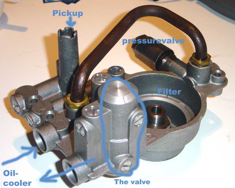

Paul Minnaert Posted October 31, 2005 Posted October 31, 2005 for an educational note, I riped of the centauro engine it have, the oilwizzard. This shows how wrong things can go. See all the screws ( 7) in the picture. How much working hours does such a thing cost? The screws are only to close holes. Not to mention the weight. The whole oilpan including this weighs 4kg. I'm shure my V pan is less. But the oil goes like cold: pickup>pump>filter>valve>engine hot: pickup>pump>filter>valve>cooler>engine as a note picture is upside down. I would like to see if the Breva pan is better, looks better anyway. Ghezzi had it mounted on the mgs01 too.

luhbo Posted November 1, 2005 Posted November 1, 2005 my 1225 daytona does without when it's not to hot. you can conect this with a thing like this: 65407[/snapback] Just one question: if the valve is closed the oil goes where it should go, means through the engine. Now, what happens when the temp.-valve opens and the two cooler connector holes are just closed, bolted without the bridge that Paul shows above? Is the oil-cooler sitting in the main stream or would the oil circulate in this case through the engine as well? (hope this language construct is clear enough to be understood ) Hubert
jrt Posted November 1, 2005 Posted November 1, 2005 I don't think it will make a difference. oil flow when valve closed (cold) -------- .....| -------- valve open -------- ....|....|| -------- Where || is the part Paul made (or the oil cooler) and | is the internal bypass or regular flow through the motor. so- with the valve open, the oil flows through Paul's part, but whether the valve is open or closed- the oil still flows through the motor. Just my guess. edit- dang it, the spaces dont show up- ignore the periods- they are placeholders.
Paul Minnaert Posted November 1, 2005 Posted November 1, 2005 well, I didn't disasemble the valve, so I don't know if all oil goes trough the cooler when valve is open. When it also could take the bypass, why should it flow through the cooler? So just closing the holes, will give no oil when engine is warm. I suppose, who wants to try? But don't complain I told you to do that.
Guest jedione68 Posted November 2, 2005 Posted November 2, 2005 Just one question: if the valve is closed the oil goes where it should go, means through the engine. Now, what happens when the temp.-valve opens and the two cooler connector holes are just closed, bolted without the bridge that Paul shows above? Is the oil-cooler sitting in the main stream or would the oil circulate in this case through the engine as well? (hope this language construct is clear enough to be understood ) Hubert 65627[/snapback] Cooler, It's a great question with a strange old answer. Go look in a 1970's Moto-Guzzi manual, first notice that and how the oil goes through the engine. Then look at some early 80's books and see that "Racers" add an oil cooler to the same 1970's engine. Now look at your v11, and you'll see Guzzi added a cooler in the same fashion... so in turn. Take it off/cap it, you have the same engine/oil pump/system since pretty much to the beginng, a Guzzi V7sport. Peace, rubbersidedown, JEDIONE68
