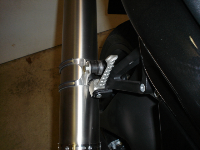

windchill Posted November 8, 2005 Share Posted November 8, 2005 As promised Link to comment Share on other sites More sharing options...

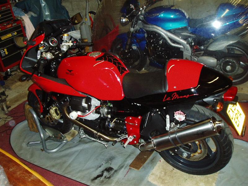

windchill Posted November 8, 2005 Share Posted November 8, 2005 And from the other end Link to comment Share on other sites More sharing options...

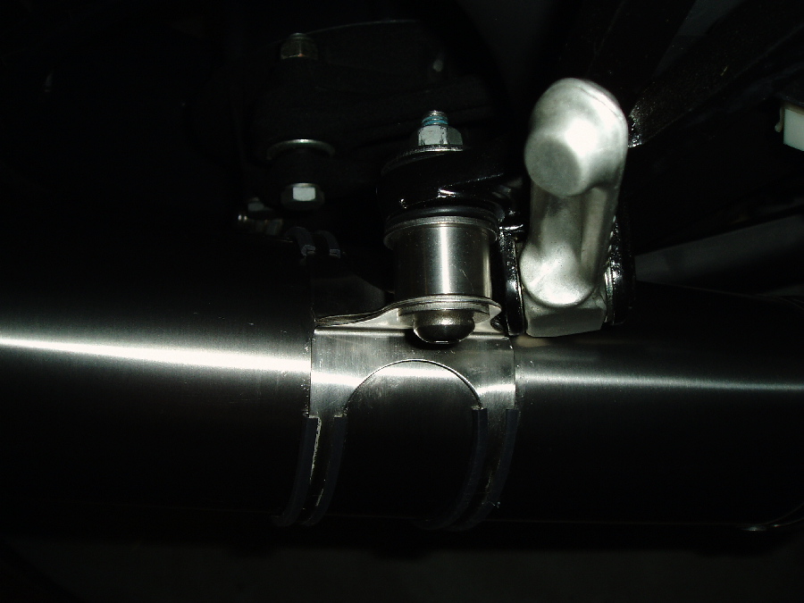

windchill Posted November 8, 2005 Share Posted November 8, 2005 And this was the spacer setup. How small do pics need to be? Link to comment Share on other sites More sharing options...
rocketman Posted November 8, 2005 Share Posted November 8, 2005 And from the other end 66519[/snapback] Looks good Windchill. Hmmm...Looks just like mine. May I say, you have good taste in motorcycles, red and black LeMans. Looks like you need to take it out and get it dirty. Rocketman Link to comment Share on other sites More sharing options...
windchill Posted November 9, 2005 Share Posted November 9, 2005 Yeah, but if I do that, something else will fall off or break!! It's all together again now, and I'm happy with it, so I need to persuade my wife to let me put it on a rolloing road in the lounge!!! Link to comment Share on other sites More sharing options...
