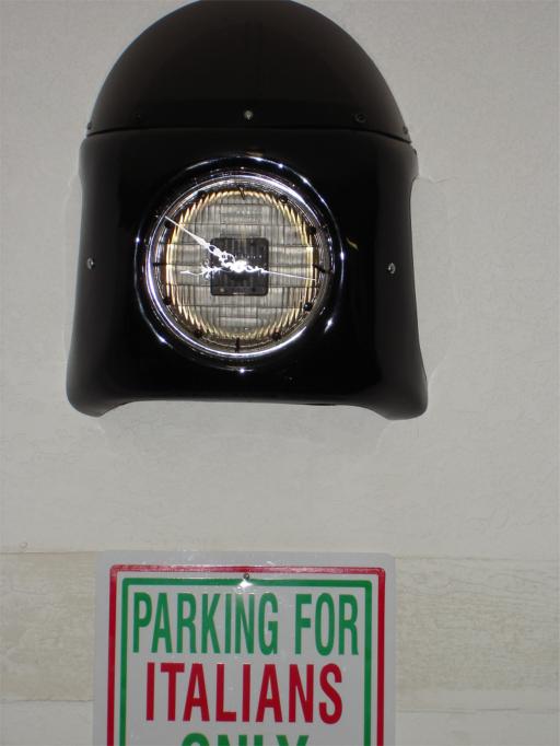

Mike Stewart Posted December 9, 2005 Share Posted December 9, 2005 If I made a clock out of every screw up I have done, there wouldn't be any wall space left in the house This is just one of those screw ups... I bought this cheap fairing for my 00 V11 Sport and tried to cut the windscreen down with a jig saw and it shattered Sooo, I took a sealed headlamp and cut the backing off ( a few hour job), drilled a hole through the glass and installed the fixings to make a clock. I still want to put a low voltage light in the back to make it light up. Someday Mike just get it polished, cut the alternator part out and stick a clock in there and then sit it on your mantlepiece as a conversation piece when your hateful in-laws come round . Pete 70095[/snapback] Link to comment Share on other sites More sharing options...
