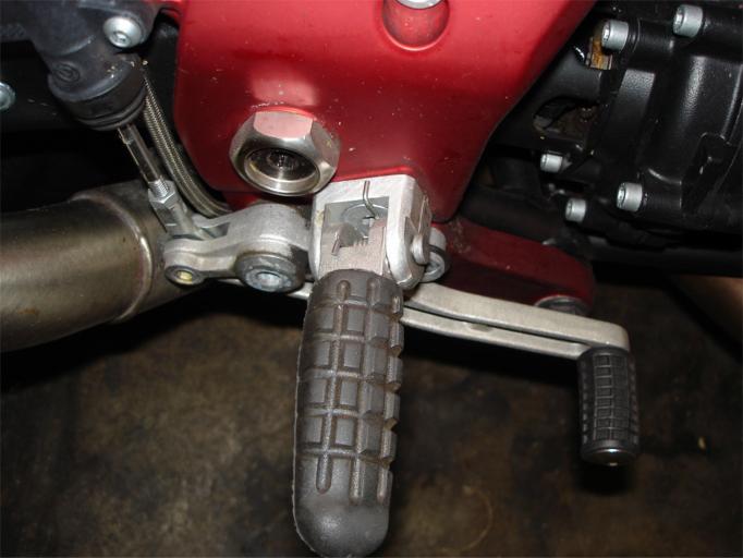

V11UK Posted December 2, 2005 Posted December 2, 2005 This is the Nevada rear footrest fitted on my V11. They don't look out of place on the bike - being no longer than the standard V11 peg. They're not spring loaded of course but they do have free movement. Vibration problems have been totally eliminated. Nevada 750 part numbers required: 1 off 66 44 07 30 right hand mounting bar/pin 1 off 66 44 18 30 left hand mounting bar/pin 2 off 66 44 16 30 washer 2 off 51 60 98 00 washer 2 off 66 44 32 30 footrest rubber 2 off 31 44 12 60 footrest plate I used these stainless steel fasteners to mount them: 4 off M3 x 16 setscrews 4 off M3 washers 2 off M6 x 40 setscrews 4 off M6 washers + 4 or 6 for spacers within the original V11 mounts 2 off M6 nyloc nuts

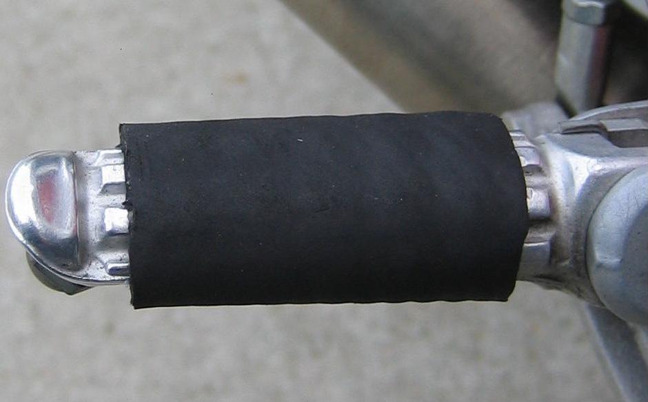

Guest ratchethack Posted December 2, 2005 Posted December 2, 2005 This thread started me thinking about pegs. Many thanks, Rick. I didn't know if I'd like this or not, but after riding on 'em for a few days, it's a definite YES! - I'm leaving 'em on. Leftover crankcase breather hose cost: $0 time to install: 10 min. force required: lots vibration control: was alright to start with, might actually be better now comfort: significantly better traction: oh, yeah - LOTS better

bigbikerrick Posted December 3, 2005 Author Posted December 3, 2005 This thread started me thinking about pegs. Many thanks, Rick. I didn't know if I'd like this or not, but after riding on 'em for a few days, it's a definite YES! - I'm leaving 'em on. Leftover crankcase breather hose cost: $0 time to install: 10 min. force required: lots vibration control: was alright to start with, might actually be better now comfort: significantly better traction: oh, yeah - LOTS better 69408[/snapback] Hey Thats a pretty good idea, Im going to try that until I find some japaneese bike pegs that fit. Maybe I can even go all out and find some red colored hose at the local euro car shop( honda civic with huge fart can muffler) that way no one can say my bike looks "Ghetto" HeHeHe.

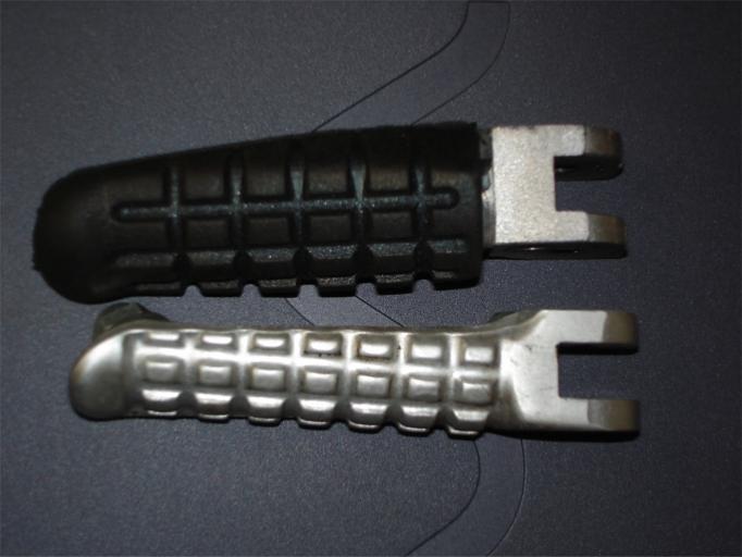

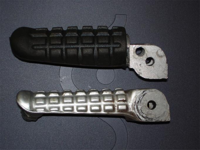

Mike Stewart Posted December 15, 2005 Posted December 15, 2005 OK, after reading all about pegs and knowing the footpegs look really close between the V11 and the Ducati Monster, I went out to the garage and installed one foot peg from a Ducati Monster onto the Rosso. Fits perfect, no fuss, no mess! The spring is a little harder to put in but not bad. So if you need a slightly cheaper alternative, find a set of footpegs from a 1994 to 2006 Ducati Monster with the standard swingarm setup, not the newer Monsters with the one sided swingarm. Also, the Monster's came with either all aluminum footpegs or the rubber topped ones. The front and rear footpegs are the same part number on the Monster's and not on the Guzzi. I purchased 4 rubber coated Monster pegs for $42.00 on ebay last week (needed them for my wifes old Monster), so the price is right. Mike I hear the Ducati Monster pegs also fit. Simpler yet, go to the athletic store and get some inexpensive insoles for your sneakers. You can get them with gel pads. "Spenko" makes some that are better than the "Dr. Shoals" stuff. What size do you wear? I have some black Alpinstar 'boots' that are styled like hi-tops. Like new and yours if they'll fit. 69355[/snapback]
