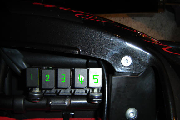

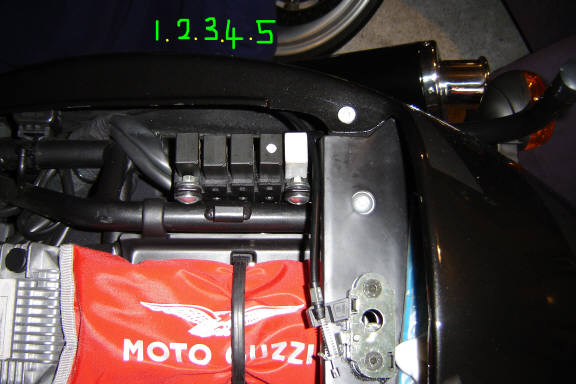

dangerous Posted December 13, 2005 Posted December 13, 2005 Ok... now I need ya help here for a minute thanks. my new 2004 Nero Corsa V11 has been giving me shit as you may have read already, but what I need to know is the order of the relays so as I can beter sort the bloody things out. Who does what? and which goes were? Thanks
O2 V11 Posted December 13, 2005 Posted December 13, 2005 Ok... now I need ya help here for a minute thanks.my new 2004 Nero Corsa V11 has been giving me shit as you may have read already, but what I need to know is the order of the relays so as I can beter sort the bloody things out. Who does what? and which goes were? Thanks 70448[/snapback] From the front mine are: 1 Starter 2 Lights 3 Neutral (sidestand safety relay) 4 ECU 5 Fuel The starter relay is a 5 pin job and the rest are 4 pin ones. I wouldn't think they would be any different from yours. Are you not getting much help from Woods on this one? Rob
zappa Posted December 13, 2005 Posted December 13, 2005 From the front mine are:1 Starter 2 Lights 3 Neutral (sidestand safety relay) 4 ECU 5 Fuel The starter relay is a 5 pin job and the rest are 4 pin ones. I wouldn't think they would be any different from yours. Are you not getting much help from Woods on this one? Rob 70451[/snapback] Hi guy's just been in the shed, found my old semeins relays 4 are 5 pin and 1 is 4pin looks like every bike might be different. Can't remember what order they were in tho. Anyway I replaced all mine with Bosch 0 332 207 307 and they are all 5 pin Whats E Woods doing for ya Dangerous? Cheers
dangerous Posted December 13, 2005 Author Posted December 13, 2005 From the front mine are:1 Starter 2 Lights 3 Neutral (sidestand safety relay) 4 ECU 5 Fuel The starter relay is a 5 pin job and the rest are 4 pin ones. I wouldn't think they would be any different from yours. Are you not getting much help from Woods on this one? Rob 70451[/snapback] thanks for that, Woods....... well hmmmmmm
dangerous Posted December 13, 2005 Author Posted December 13, 2005 Hi guy's just been in the shed, found my old semeins relays 4 are 5 pin and 1 is 4pin looks like every bike might be different. Can't remember what order they were in tho.Anyway I replaced all mine with Bosch 0 332 207 307 and they are all 5 pin Whats E Woods doing for ya Dangerous? Cheers 70452[/snapback] My 1100i sport used semeins and they were crap... but the V11 is ment to have a beter brand in it, looks just the same but with a differant name on it. anyway I have replaced the relays with #307 & #310 so time willl now tell. as far as E Woods goes well, they did take the bike in straight away and look at it, it even stoped on them, they said 'buggered if we know whats up' well I asked if we could replace the relays they said they should be ok...... So after a chat they decided to give me 2 relays (wanted me to pay for em at 1st) and I brought 2 more (not from them) so we shell see. All this only happened cos when I went to pick it up after they said its fine.... <_ it wouldent start src="%7B___base_url___%7D/uploads/emoticons/default_knownothing.gif" alt=":huh2:">
