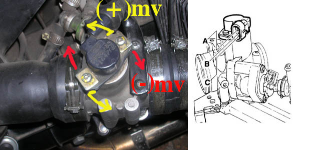

dlaing Posted December 25, 2005 Share Posted December 25, 2005 Regarding your leaner plug reading, it is difficult to tell from the photograph if that is all black than it is too rich. If it has tan colors mixed in like image 7, than it MAY be ok. But it does not look tan to me. You can ignore the black on the perimeter, as that is normal, but the blackness of the insulator indicates that it is far too rich. Because of the camera flash it is difficult to photograph, but it looks like mostly black with white ash, which I believe would indicate a combination of too rich and too lean. The look of white may just be the glow of the camera flash. In any case, you may have found your solution by setting the TPS correctly! It was way off, but strangely in the lean direction....weird. Here is an article you may enjoy. http://www.visi.com/~moperfserv/sport_11.htm Keep in mind the Creedon chip in this article is probably several revisions old. Link to comment Share on other sites More sharing options...
