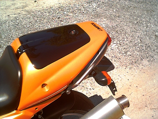

CafeMan Posted January 14, 2006 Share Posted January 14, 2006 I recently replaced my pillion seat with a cowl that needed to be painted, and went the rattle can route. I found a great site (can't locate it now!!!!, but here's another detailed one) where someone did a step by step with photos. The key is prep, lots of wet sanding and most importantly, patience. All I needed was the paint as I already had the other stuff lying around....turned out pretty damn good for a first attempt. Looks better than what this photo shows...... It "can" be done!! Repaint Link to comment Share on other sites More sharing options...

mdude Posted January 16, 2006 Share Posted January 16, 2006 I recently replaced my pillion seat with a cowl that needed to be painted, and went the rattle can route. I found a great site (can't locate it now!!!!, but here's another detailed one) where someone did a step by step with photos. The key is prep, lots of wet sanding and most importantly, patience. All I needed was the paint as I already had the other stuff lying around....turned out pretty damn good for a first attempt. Looks better than what this photo shows...... It "can" be done!!Repaint 74458[/snapback] hey CafeMan, where did you get that Laverda cowl? Thats something for the missus' Ghost. Link to comment Share on other sites More sharing options...
Van Posted January 17, 2006 Share Posted January 17, 2006 I recently replaced my pillion seat with a cowl that needed to be painted, and went the rattle can route. I found a great site (can't locate it now!!!!, but here's another detailed one) where someone did a step by step with photos. The key is prep, lots of wet sanding and most importantly, patience. All I needed was the paint as I already had the other stuff lying around....turned out pretty damn good for a first attempt. Looks better than what this photo shows...... It "can" be done!!Repaint 74458[/snapback] Hey, CafeMan, that looks great !! l agree with the perfectionists, a tank, paint by a pro...but for a small item like a cowl,,see, a rattle can will work !! Cheers van Link to comment Share on other sites More sharing options...
