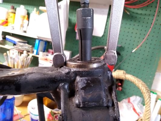

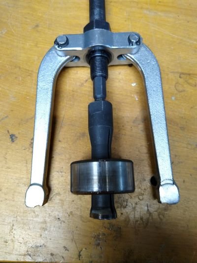

CagivaRider Posted January 29, 2020 Share Posted January 29, 2020 (edited) After days and days of fighting with the driveshaft-side swingarm bearing I succeeded in getting it out. My first try was to just use heat with my good inside puller and a slide hammer. No luck. I ordered a cheapo puller kit that took either a slide hammer or two-jaw puller. None of its pullers fit snugly in the bearing. I ground the closest puller to the right size and modified its two-jaw puller to fit on the very thin area around the bearing. I cranked it tight and the bearing pulled out. I had to grind a lot of metal off the original puller to get to the one sitting on the bearing: I ground the two-jaw puller to have a slight hook to fit the narrow material surrounding the bearing. Here's what it looked like after I pulled the bearing. You can see the hooked inner surface of the puller legs. Edited January 29, 2020 by CagivaRider Added pictures 1 Link to comment Share on other sites More sharing options...
po18guy Posted January 29, 2020 Share Posted January 29, 2020 Good job on a purpose-built tool. +1 Big ol' pipe from the opposite side would not drive it out? Or, is it a blind hole? Fortunately, have not had to tear the project down that far... yet. Link to comment Share on other sites More sharing options...
CagivaRider Posted January 30, 2020 Share Posted January 30, 2020 It's a blind hole with very little space below the bearing. Link to comment Share on other sites More sharing options...
