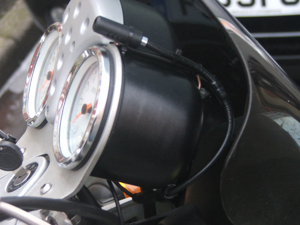

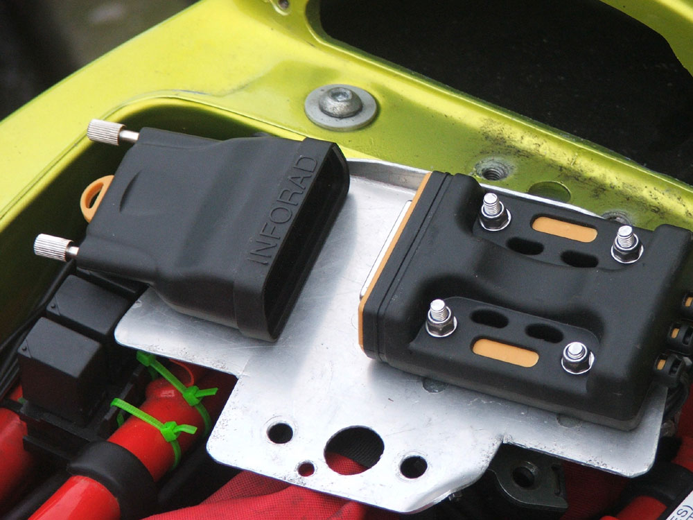

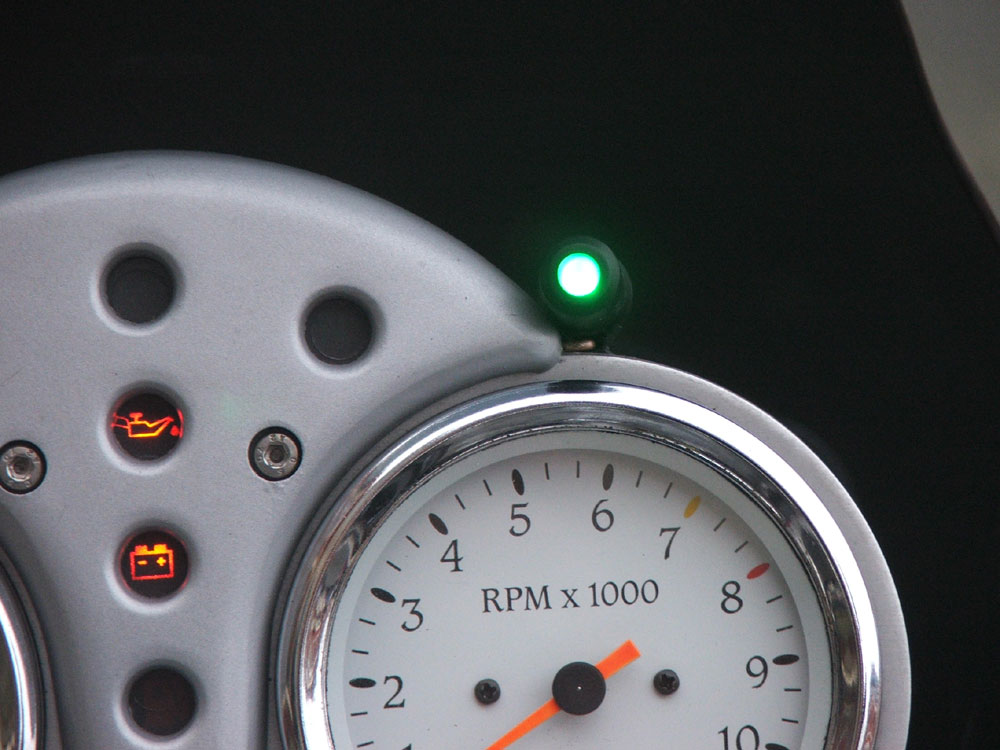

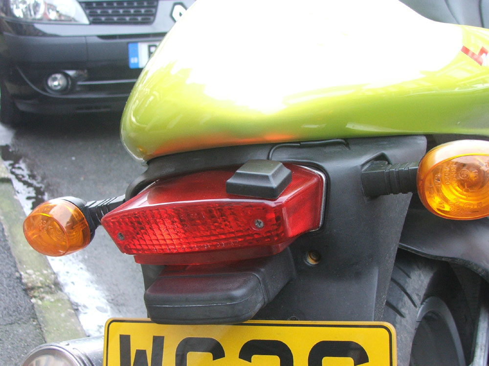

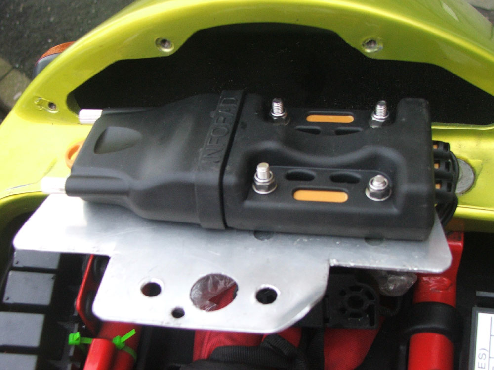

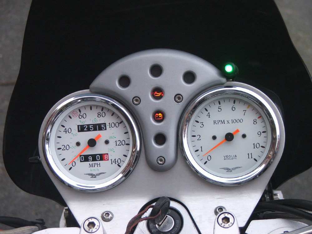

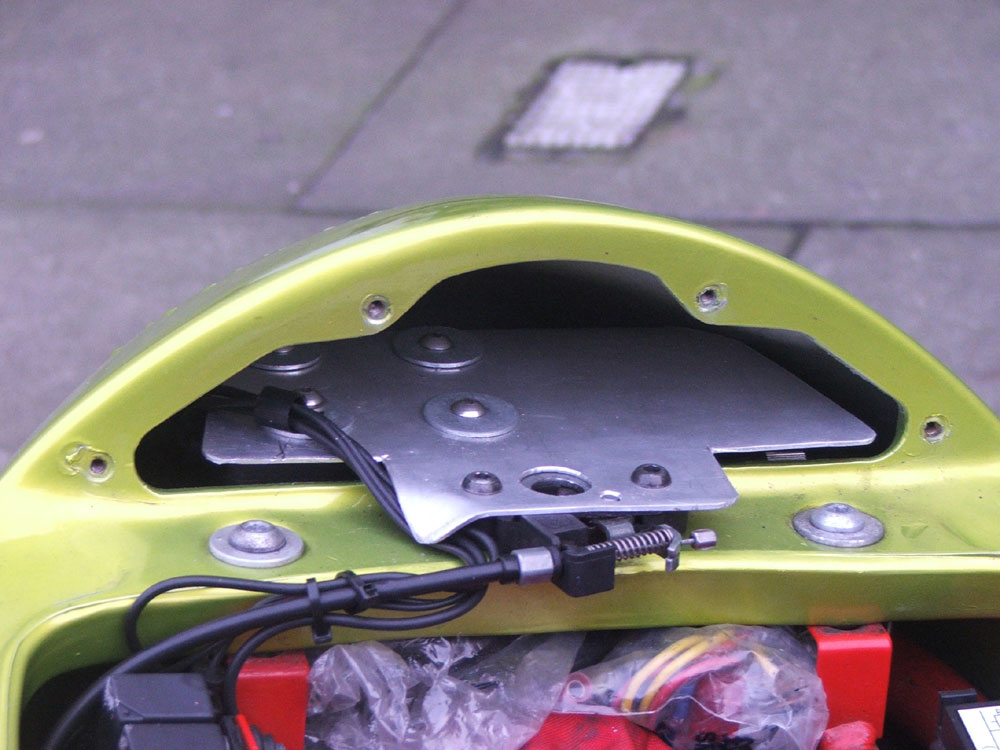

wambiker Posted January 25, 2006 Posted January 25, 2006 Hi all, this may be of interest to the european members of this forum. In the UK the use of fixed speed cameras has become a total pain in the a**e . I have been trying a new unit which may be off some help called the Inforad GPS speed camera warning system. I know some of the newer sat nav systems can warn you of cameras but these require the whole system, which I neither want nor can afford at the moment. This system has a main body, with detachable database unit, a gps anntenna, and a very bright led mounted on the end of a flexible wand. The only connections are power and earth all the others are pre wired. The unit is quite bulky and the best location I found was in the tail unit on an aluminium plate, the anntenna is the black square unit attached to the top of the tail light lens(it has to be able to see the sattelites. The display led is attached to the clocks. The pictures hopefully will make this clear. So far it seems to be pretty good it has shown me all bar one speed camera I have come across, it is always only going to be as good as its database, which is upgradeable, it has also warned me off a couple that did not exist and on motorways also shows up a couple locally just of the junctions on other raods if they are within range. The database unit conects via a lead to the pc and can be upgraded from inforads website through the managemnt system that comes as part of the set-up, it only detects fixed sites by gps location not mobile radar cameras. You can set different parameters such as how early the system warns you of an up coming camera. The display is green normaly, red when approaching the camera and flashing red if you are over the speed for that camera, useful if you are not exactly sure what the speed limit at the camera is. I have no links to the company, I just bought the unit in my mates bike shop to see if it was any good( did manage a small discount as guinea pig ), and thought it might be of interest to people. If you want more info please get back to me. The company has a website at www.gpsinforad.co.uk If you are interested and can't find a unit locally my mate John can be contacted at Bridge Road Motorcycles. Again I'm not trying to drum up business just pass on the information if anyone is interested. Cheers Gary.
wambiker Posted January 25, 2006 Author Posted January 25, 2006 Sorry missed a couple of the pics off the post - here they are
