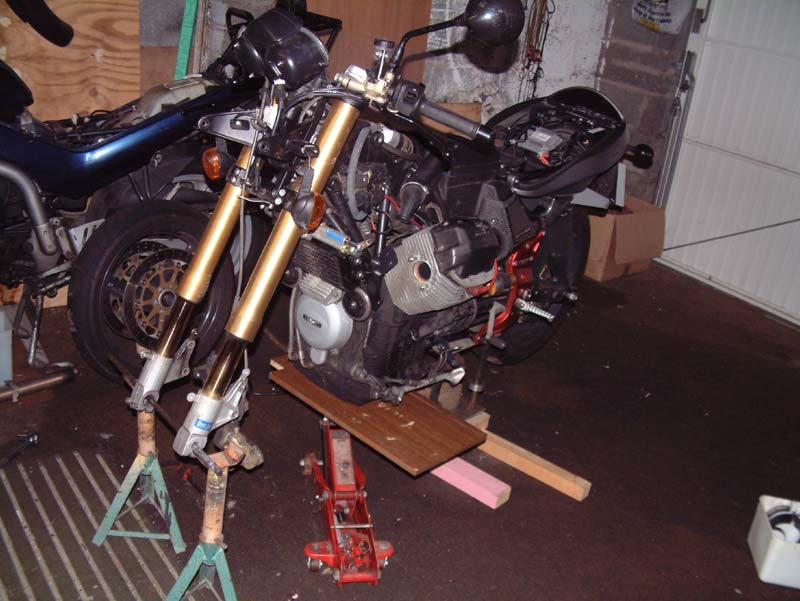

Ballacraine Posted April 23, 2006 Author Posted April 23, 2006 OK Here is how I set up. Not elegant but it was stable..... Since then I got lucky on ebay and have the proper stand with wheels ( If this post works with the attachments I should be on a roll for tomorrow! ) Nige.

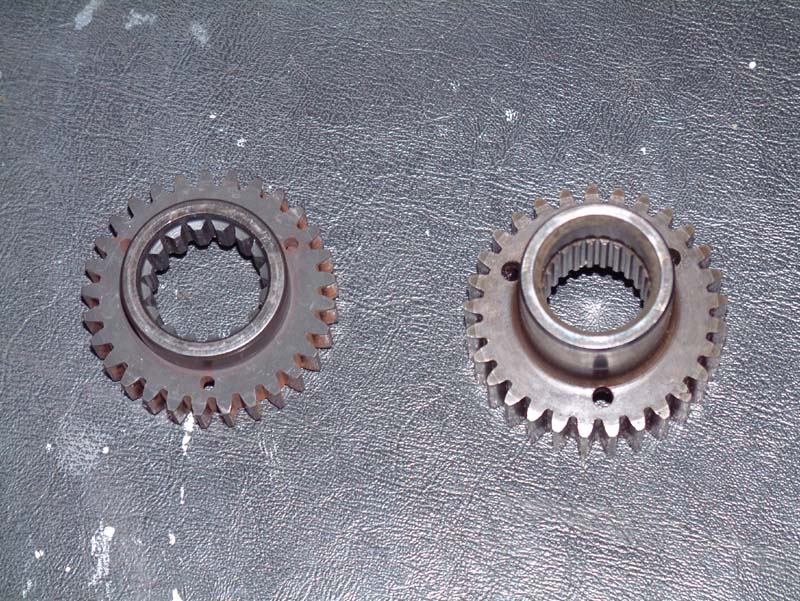

Ballacraine Posted April 24, 2006 Author Posted April 24, 2006 Right, this is the offending article. One of the torx head screws put up a real fight. Busted my cheap T bar and also on a later attempt the Torx bit! Ended up having to drill the head off it! I took it into work today to get it crack tested. I am not expecting it to show damage TBH, but as I said earlier there were two bolts in the central hub looser than I would have liked. Here is the shallower Scura single plate clutch hub centre: On this shot you can see the deeper splines and smaller bore of the twin plate five speed clutch hub centre on the right, compared to the removed Scura single plate six speed clutch hub centre. I had to order up a twin plate 6 speed clutch hub centre to to the job. Nige.
Ballacraine Posted May 2, 2006 Author Posted May 2, 2006 Right, just to conclude this excercise.... Having had a friend NDT penetrant test the alloy flywheel removed from my bike. As I mentioned earlier in the thread two of the mounting bolts were not as tight as I would have liked them. There was 6500 miles on the bike when I took it off. It had started to crack on one of the mounting holes already. Have to stress (sic ) Scuristi! This definitely seems a 'When' situation...rather than an 'If.' I am so relieved I went to the trouble of swapping the offending article for a sound V10 ten spring twin plater. I would urge others to take remedial action before they become another statistic! Don't hope it will go away....It won't unless you take action. Get Nige.
