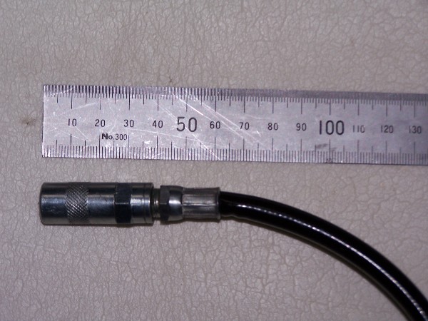

grossohc Posted March 29, 2006 Posted March 29, 2006 I have just bought a draper mini grease gun to see if it will do the job, it has a smaller head than normal which should clear the shaft, i am going to modify (fit flexible line) so i can grease it from the side of the bike hoprfully. Or it could be flung to the other side of the garage if it is no use. Put"mini grease gun " on ebay and see if anything that is useful turns up. Gary
twhitaker Posted March 29, 2006 Posted March 29, 2006 I bought an extension with 180 degree swivel coupler from Ace Hardware. McMaster Carr has the same thing for $12.61 Part number 1090K47 I have to pull the wheel and reach in along the swing arm but every 12,000 miles is only once or twice a year.
mike wilson Posted March 29, 2006 Posted March 29, 2006 For UK subscribers: Flexible hose for attaching to your grease gun http://www.cromwell.co.uk/static/publicati.../pages/1005.pdf End fittings and nipples http://www.cromwell.co.uk/static/publicati.../pages/1007.pdf Grease nipples if you need many http://www.cromwell.co.uk/static/publicati.../pages/1222.pdf Home (for ordering) http://www.cromwell.co.uk/index

Frenchbob Posted April 1, 2006 Posted April 1, 2006 I have just bought a draper mini grease gun to see if it will do the job, it has a smaller head than normal which should clear the shaft, i am going to modify (fit flexible line) so i can grease it from the side of the bike hoprfully. Or it could be flung to the other side of the garage if it is no use. Put"mini grease gun " on ebay and see if anything that is useful turns up. Gary 84196[/snapback] I've got one of those; I couldn't get on it! Mike, those are really useful sites: thanksfor posting the links. I was talking to my dealer the other day: he reckons it has to be dismantled, and that's the way he does it. I'm determined to do it without. While I was there, sat on a Greaso: it was yellow, which didn't help. I really do prefer my V11. I was also taken in the back to see and hear a customer's Nero Corsa being run up on a new Stucchi crossover and Ti cans. This is why I do my own work!

grossohc Posted April 13, 2006 Posted April 13, 2006 I have just bought a draper mini grease gun to see if it will do the job, it has a smaller head than normal which should clear the shaft, i am going to modify (fit flexible line) so i can grease it from the side of the bike hoprfully. Or it could be flung to the other side of the garage if it is no use. Put"mini grease gun " on ebay and see if anything that is useful turns up. Gary 84196[/snapback] Flung to the other end of the garage, well it was a good idea with a drink inside me.
