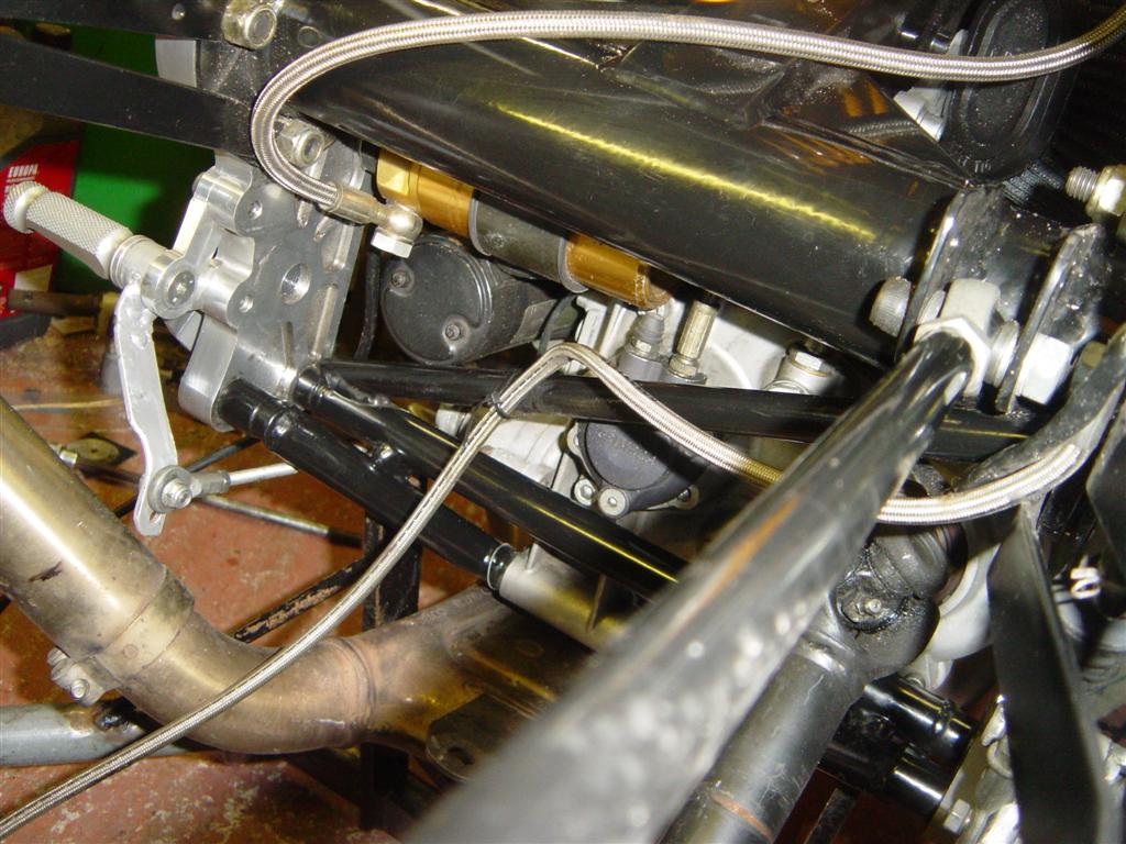

Paul Minnaert Posted August 22, 2006 Posted August 22, 2006 Tonight I was going to grease my joints. I took the swingarm out, when you take the rearwheel out there is not much to do to get it out. Even silencers can stay where they are. Because my swingarm is a bit modded at the front, there is no other way to reach the front joint, well if guzzi had mounted the front nipple on the other side of the crss it would have been easy for me.
