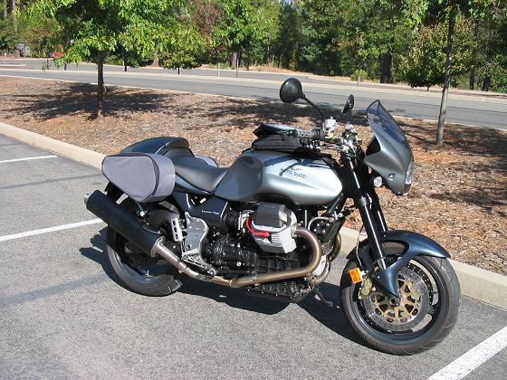

I purchased a set of RKA bags - they hold their shape and work fine for me - they strap on - the only issue is that they are not quick to take off -
Here is a pic:
Does anyone happen to have an explaination or even better some photos of the mounts?
90282[/snapback]
The front mount attaches through a sleeve to the front passenger peg hanger. I shortened my sleeve by about 1/2 and use shorter bolts to narrow the profile. The lower mount fastens to the muffler hanger. I moved mine to the inside ( more narrow. Finally, the rear mount bolts inside the the rear fender.
I dispensed with the spacer alltogether it was too wide to fit inside the bolt head recess, and I've got the lower on the outside. Being a wire frame its fairly flexable and will tweek to however you want it.
Though it did break one of the joins when I first used it but was easily bodged back
