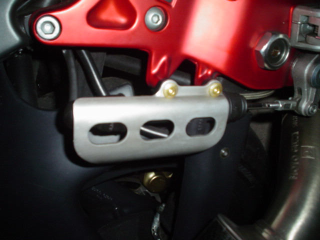

orangeokie Posted June 9, 2006 Posted June 9, 2006 Let's try this one (please comment if needed!)Aluminium: Pro: available in different colors, corrodes slowly Con: Expensive, will break under high tension, but easy to drill out See: AF1 Racing. . . 90996[/snapback] Here's what the AF1 tank bolt set looks like in gold . . .
