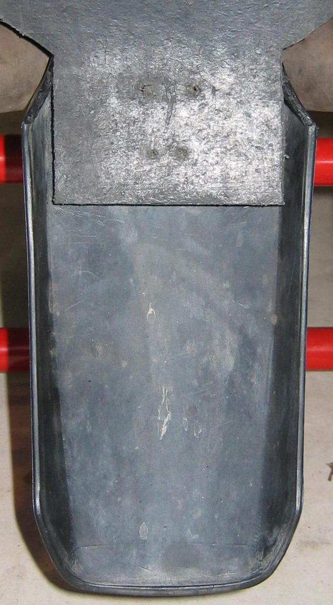

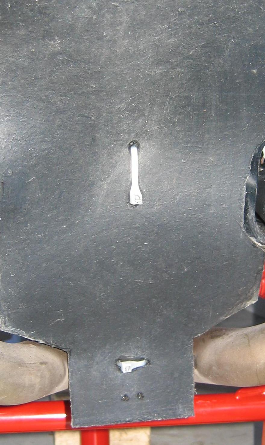

Guest ratchethack Posted May 6, 2007 Posted May 6, 2007 Well, it's taken me this long to get a ROUND TUIT per post #2 above. . . I put 2K of the 7.5K miles on my last Z6 rear with a plug in it. While I've never hesitated riding on a properly plugged tire as long as it was a "clean" job, after plugging, I always keep the speed down and I'm none too keen on the idea of having a plug in there. For me, wot's even worse than a plugged tire is the nagging thought of being out somewhere on the Back Side o' Beyond -- maybe at night, maybe in the rain -- and picking up a nail -- which of course, can happen at any time, regardless. . . . I replaced a scuffed-up front fender on my big single trailie awhle back. Looking at the old plastic fender, it suddenly became clear that I'd no longer be able to put off my longtime idea to test out a "nail deflector". Of course I'd been threatening to put one on for years, every frickin' time I've pulled a nail, screw, bolt, or wot have you) out of a rear tire (it's always the rear tire that picks up the offending dagger). Cut off and whittled down a little, the old front fender was the correct size, material, and it had just about the perfect curve and angle on it to fasten up to the subframe and crossover hanger with zip-ties -- right under my previously installed Bodge Guard. So, along with a new Z6 and clutch bleed, driveshaft lube, swingarm bearing inspection and rear brake caliper cleaning, my Guzzi's getting this here nail deflector (see below). Do I expect this to ELIMINATE punctures? Well of course not. Do I expect a LOWER PROBABILITY of punctures? Quite possibly. The miles will tell the tale. FWIW, the photo on the right is the Bodge Guard previous to adding the deflector. It's zip-tied up to the swingarm, and it's been doing a fabulous job keeping the trans and shock nice & clean. Fits nicely with the deflector, dunnit?

dlaing Posted May 6, 2007 Posted May 6, 2007 Do I expect this to ELIMINATE punctures? Well of course not. Do I expect a LOWER PROBABILITY of punctures? Quite possibly. The miles will tell the tale. Nice job I think it will lower the probabillity, but the most threatening debree might have been coming in low below the deflector. Perhaps if you extended it close to the ground with a brush or broom, and angled it it to deflect to the side rather than bounce towards the tire. And FWIW I don't think the miles will tell the tale. I am at 37,000 miles without a puncture, and I ride the same roads as you and your riding buddy. Maybe you need karma bells Your bike now weighs HOW much???? I think he is trying to turn his silk purse into a sow's ear But that plastic is down low and does not contribute much to that rearward weight bias.
Guest ratchethack Posted May 6, 2007 Posted May 6, 2007 Here's a shot of the nail deflector with the bike on the side stand. Laden, the deflector is a few mm above the floor. The road will shorten it to its longest possible length. It cannot get caught underneath the tire at any point of suspension travel. Though it's flexible, it's still stiff enough to take a heavy wallop and maintain its shape. More cheap insurance, this time based on a little theory and more'n a few decades of observation. With any luck, I won't have anything more to report on this.
Guest ratchethack Posted May 7, 2007 Posted May 7, 2007 Perhaps if you extended it close to the ground with a brush or broom, and angled it it to deflect to the side rather than bounce towards the tire. . . . But that plastic is down low and does not contribute much to that rearward weight bias. Well Dave, as a matter of fact, converting my Guzzi into a 2-wheel street sweeper by mounting a brush or a broom on it was my first thought! My second thought was to mount a 5-gallon shop vac on the forks below the headlight, which would improve that rearward weight bias , and run the vacuum hose down to a power brush floor sweeper attachment mounted in front of the rear tire on a swivel for roll allowances up to max lean angles. But converting the AC motors (both vacuum and power brush attachment) to DC current without significant efficiency losses through a converter, or replacing the motors --either one -- would've been a bit of a challenge. And since the typical shop vac and power brush attachment draw a min. of about 12 amps combined, and power floor sweepers probably wouldn't take very kindly to the roads I ride (let alone the speeds ), I decided this idea just couldn't suck enough. But it was a great thought, nonetheless!

mike wilson Posted May 8, 2007 Posted May 8, 2007 Here's a shot of the nail deflector with the bike on the side stand. Laden, the deflector is a few mm above the floor. The road will shorten it to its longest possible length. It cannot get caught underneath the tire at any point of suspension travel. Though it's flexible, it's still stiff enough to take a heavy wallop and maintain its shape. You'll have to remember it's there is you ever need to ride up a kerb or something similar. The corner will push it against the tyre. A friend of mine forgot about the mudflaps on his car when backing up over a kerb and ripped holes in the back wings. Got out, cursed and ranted for a while, got back in and carried on and ripped the mudflaps out of the _front_ arches...........
