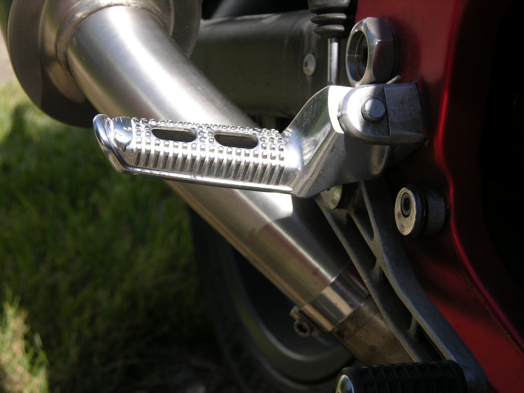

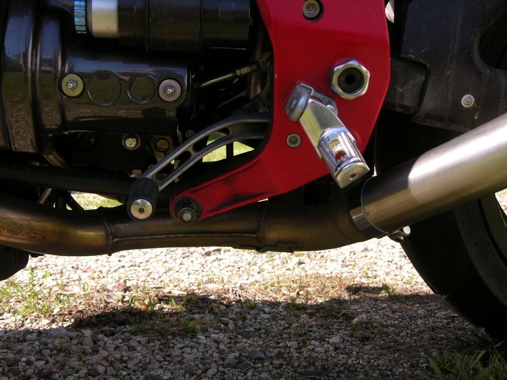

gargoyle Posted June 4, 2006 Posted June 4, 2006 I installed my new Buel footpegs. What a difference that little inch makes. Much more confortable. Time for an Iron Butt run. Well maybe just a trip to Virginia to try'em out.

dlaing Posted June 5, 2006 Posted June 5, 2006 I really like the first two from rossopuro! High pegs low bars! I also like that Quat-D exhaust that's on that bike, I'm starting to get the itch for some new parts! No scratch right now. 91183[/snapback] One thing that keeps the rear sets from going back AND down is the exhaust pipe. But with the Quat-D that is NOT a problem. I would love for the pegs to go back three and down about two inches, and the Quat-d would open up that possibility. It would also be nice to convert the gear shifter to a linkless one up - five down (helps prevent theft : ) But for a lot less money the Buell pegs give an inch, and I presume the rider's heel does not hit the exhaust

gargoyle Posted June 6, 2006 Author Posted June 6, 2006 Is that a straight swap out or did you have to make any modifications? Lee 91296[/snapback] I just had to bolt them on. All the mods that needed to be done were compelted by the previous owner of the pegs and are covered in the thread to which I have supplied a link to below. http://www.v11lemans.com/forums/index.php?showtopic=3391&hl=
Guest Britcheflee Posted June 9, 2006 Posted June 9, 2006 So I went down to the Harley store today - bought the pegs - one interesting thing is that the price of the LH side peg was 12.80 and the RH side peg was 15.95!!! The springs were only .95c each though. I am going to use the existing pins so can you elaborate on the electrical conduit used to make a bushing? I dont want to drill out the holes for the same reason you gave - may wish to go back to the original pegs. Total cost including tax was $32.95 - I thought what the hell, for that price I will give it a go. Rather shocked as I was expecting them to be a lot more expensive...... There was a fancy Harley Road King on the shop floor....actually I must admit it looked very nice.....until I spotted the $19,000 price tag, plus fees and tax!!! Lee
