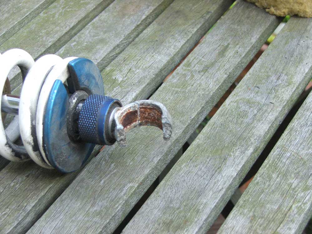

wambiker Posted June 5, 2006 Share Posted June 5, 2006 Hi all, I've just discovered that the bottom eye on my rear shock has done the breaking up trick. This is even worse as I am going to the Erin rally on Friday. Tried the breakers no joy so have taken the plunge and ordered a hagon shock, any one any experience of these? It was relatively cheap £250 compared to £350-600 for others, but it does not have a remote reservoir. But they can have it with me by courier for tomorrow, so we will see. And then at later date maybe an all singing and dancing shock (or not if this turns out to be ok). Cheers Gary Link to comment Share on other sites More sharing options...

wambiker Posted June 6, 2006 Author Share Posted June 6, 2006 Hi all, I got hold of the replacement Ohlins shock this morning and fitted it this afternoon,after an initial setting up the shock is so different to the sachs I was amazed. If any one has ball park settings for rebound and compression settings for the rear ohlins I would appreciate it. I have attached a couple of pictures off the broken shock for reference. Link to comment Share on other sites More sharing options...

Paul Minnaert Posted June 6, 2006 Share Posted June 6, 2006 wambiker, The picture explains all. The steel in the alu eye is so rusted, that it grows thicker, and can't turn anymore. A little oil on there once in a while would have saved it. It may not look like it , but it's a rotation point. Every time I see a british bike it's rusted, the climate must be much worse than in holland. Link to comment Share on other sites More sharing options...
belfastguzzi Posted June 6, 2006 Share Posted June 6, 2006 wambiker, The picture explains all. The steel in the alu eye is so rusted, that it grows thicker, and can't turn anymore. A little oil on there once in a while would have saved it. It may not look like it , but it's a rotation point. 91358[/snapback] Oh yes, I didn't look at that pic before – that's nasty. Martin B: was yours like this too? Every time I see a british bike it's rusted, the climate must be much worse than in holland. 91358[/snapback] It's definitely damp, especially heading north. Lots of wet weather directly in off the Atlantic. The other devastating factor is all the road salt that gets spread about every winter. Once corrosion starts to get a hold, things can go downhill badly over the course of one winter. Link to comment Share on other sites More sharing options...

Martin Barrett Posted June 6, 2006 Share Posted June 6, 2006 Oh yes, I didn't look at that pic before – that's nasty. Martin B: was yours like this too?It's definitely damp, especially heading north. Lots of wet weather directly in off the Atlantic. The other devastating factor is all the road salt that gets spread about every winter. Once corrosion starts to get a hold, things can go downhill badly over the course of one winter. 91362[/snapback] Not quite as bad as yours. Now a year on best I go and grease it. Link to comment Share on other sites More sharing options...

dlaing Posted June 7, 2006 Share Posted June 7, 2006 shock eye failure could be deadly. Glad Wambiker discovered this before it could have caused an accident. It really should be a factory recall item....but that is not likely to happen. I think we need a sort of "know the rules" faq Some candidates for the FAQ of things the factory may have gotten wrong and maintenance not in manual schedule: shock eye needs lubing or it may break. rear break caliber needs regular cleaning and very light lubing of the piston....but do NOT lube your pads and disk Make sure there is freeplay at the rear brake lever, and clean and lube the master cylinder and make sure the spring returns it. grease the shaft and hub splines. regularly grease bearings on the right side of the rear gear box Check the rear bearing spacer to make sure there is no clearance between the bearings. Orange Okie's additions: battery and relays Ground your tachometer Run you own wires to the headlights make sure the compression fitting does not pop out on the speedo cable etc. make sure your seat latch spring and engine warm up lever spring were not reversed at factory. Any more to add???? Any to subtract???? I know some disagree about brake lever clearance and brake caliber piston lubrication, so their objections should be noted. The objection to lubing near the brakes should be mentioned because lube getting on brake pads or disk could pose a serious problem. Ratchet could write a piece on the importance of zero clearance. Link to comment Share on other sites More sharing options...
