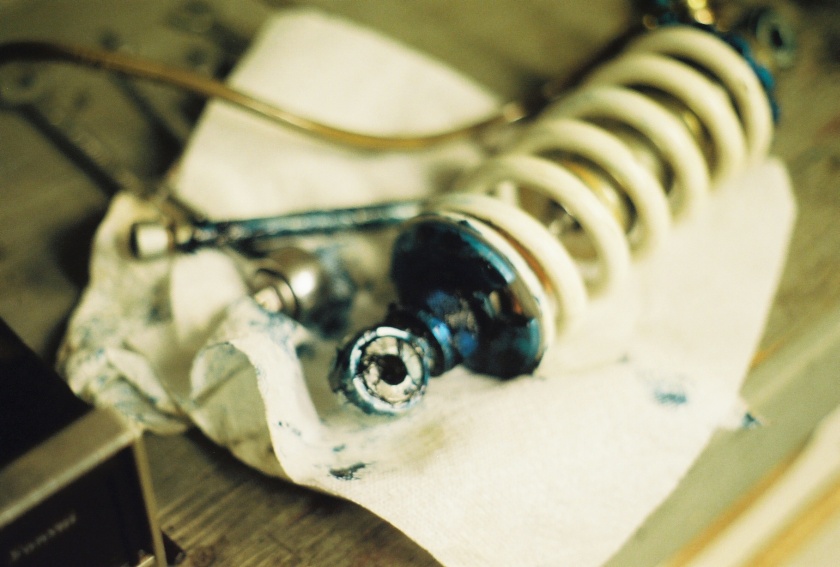

beauchemin Posted June 8, 2006 Posted June 8, 2006 Hi all, I got hold of the replacement Ohlins shock this morning and fitted it this afternoon,after an initial setting up the shock is so different to the sachs I was amazed.If any one has ball park settings for rebound and compression settings for the rear ohlins I would appreciate it. I have attached a couple of pictures off the broken shock for reference. 91337[/snapback] I think you should consider fitting a hugger - it will keep your nice Ohlins shock in good condition and the rear of your engine/tranny clean. The stock hugger is a useless piece of junk (as you undoubtedly know since you have removed it). I was able to get a Pyramid Plastics CBR600 hugger that fits fairly well (with a foam block spacer to move it rearwards away from the swingarm pivot). You could do all of us a huge favour by going to Pyramid Plastics and getting your bike custom fitted with a proper hugger. I'm sure that a decent number of them could be sold via the forum. http://www.pyramid-plastics.co.uk

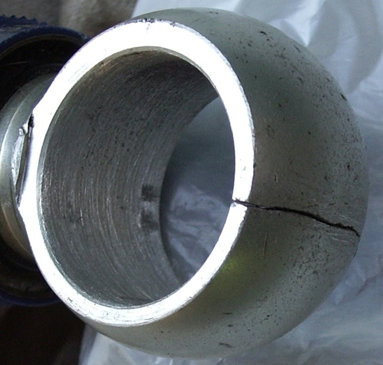

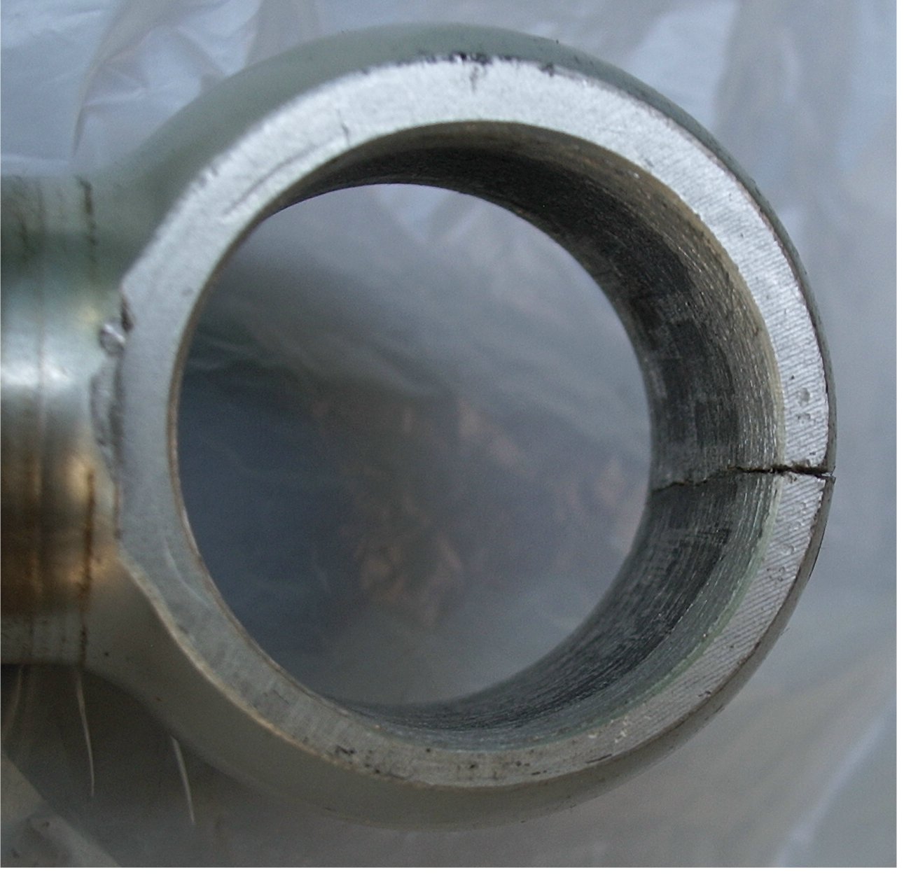

pasotibbs Posted June 8, 2006 Posted June 8, 2006 Just checked my shock and it is also cracked due to the corrosion !! I'm really glad I read this post as I am going to France in 6 weeks and you just know it would have failed in the middle of nowhere, with neither of us speaking French that would have been fun (assuming it hadn't put us under a passing Citroen that is !!!) Can anyone recommend the best course of action, is the Hagon shock ok or am I better getting a more expensive replacement ? ( I assume Sachs don't do repairs ?)

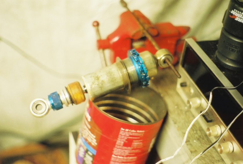

Ouiji Veck Posted June 8, 2006 Posted June 8, 2006 Sachs!! Just went through mine again. Had to rejuice it last year. Luckily it held for 15,000 mi or so. Decided to give it a whirl myself this time. It went surprisingly well. If I can get away with cleaning and refilling it once a year I'll hold onto it. Getting pretty fast at hauling it out and putting it back in. Checked and greassed up the fish eye's. So far so good. Leaving for a week on the road next week.

Paul Minnaert Posted June 11, 2006 Posted June 11, 2006 Check your Shocks that's an interesting picture, I suppose you cleanes it before the picture, do you have a picture of the things you took out? I suppose the ring inside the alu outside was heavily corroded?
pasotibbs Posted June 11, 2006 Posted June 11, 2006 that's an interesting picture, I suppose you cleanes it before the picture, do you have a picture of the things you took out? I suppose the ring inside the alu outside was heavily corroded? 91688[/snapback] yes thats after I cleaned it.I haven't got a photo of the other part but it is basically a bearing,I easily pressed it out using too sockets and a vice (the split probably helped ! )it wasn't as badly corroded as I expected and cleaned up easily(the internal "fish eye" part still moves freely and seems corrosion free). It looks like the joint part is pressed into the alloy and the corrosion that will occur when water (and in the UK salt) gets in just weakens and stresses the alloy until it fails. As others have said, keep it greased / shield it from the spray off the back wheel (who at MG thought that hugger was ok ? )and it should last...maybe. Now all I have to do is work out how to take the play out of the bevel box pinion, replace the right side bearing and when I get the new shock, put it back together again!!
