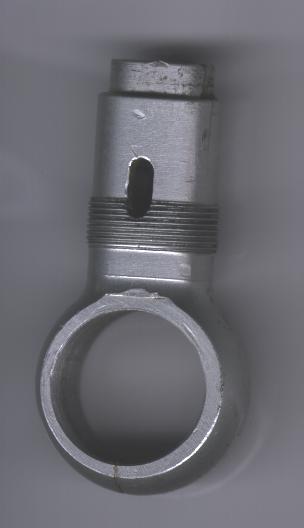

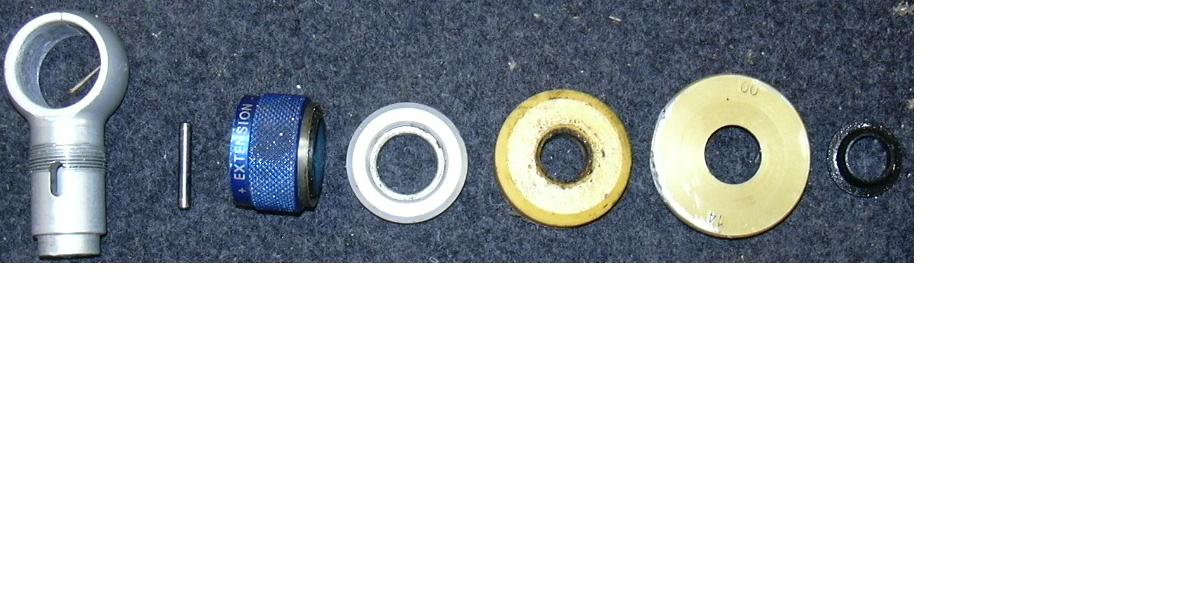

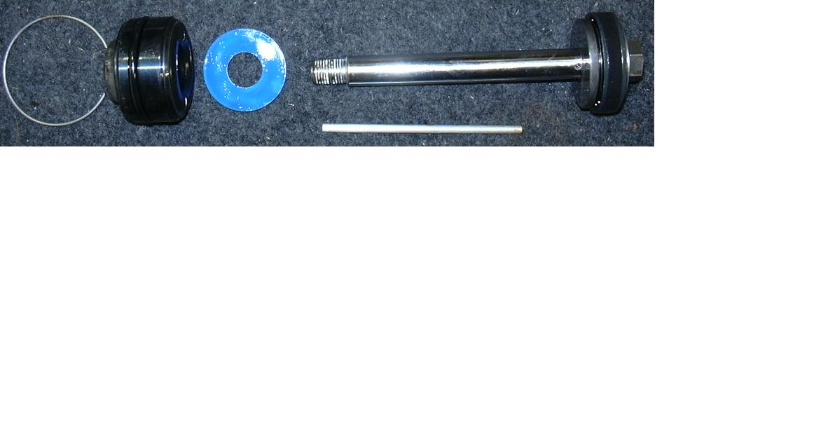

I finally got round to stripping the old Sachs Shock :luigi:damper_rod_complete.JPGparts_order.JPGDamper_rod.JPG It was much easier than I thought it would be, except that when I unscewed the "Eye" casting from the damper rod it cracked around the thread :homer: (it was only thread locked on so it seems the casting cracks with little effort which explains a lot :angry: )Anyway I thought you guys would like to see.
