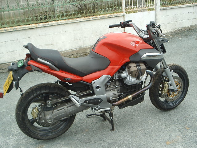

windchill Posted July 5, 2006 Author Share Posted July 5, 2006 Anyone who has fitted one of these: how tight did you find it at the front end of the engine? Mine wouldn't fit without serious surgery to reduce the overall width at the very front end of the mounting brackets. I needed to "gain" almost 3/16" to get it to slide on far enough for the holes in the pan to mate with those on the brackets. Also there is a "block" or "blank" on the bottom of the crank case casting at the front on the RHS (viewed from onboard) against which my pan is tight up. Link to comment Share on other sites More sharing options...
windchill Posted July 5, 2006 Author Share Posted July 5, 2006 BTW, using my "lightweight" torquewrench and a degree of very elusive synwir cyffredin, I found that the sump screws were allready set to 8Nm: the bottom end of the suggested 8 - 12 Nm range. Didn't use nut lock on them, I reckoned weld seal would be better given the levels of vibration present (sais gwirion) Link to comment Share on other sites More sharing options...
windchill Posted July 16, 2006 Author Share Posted July 16, 2006 A dyma ni gyfeillion!! Job done!! Just thought you might like to see it on, weldseal and all!! Why can't I post pics any more? Link to comment Share on other sites More sharing options...
