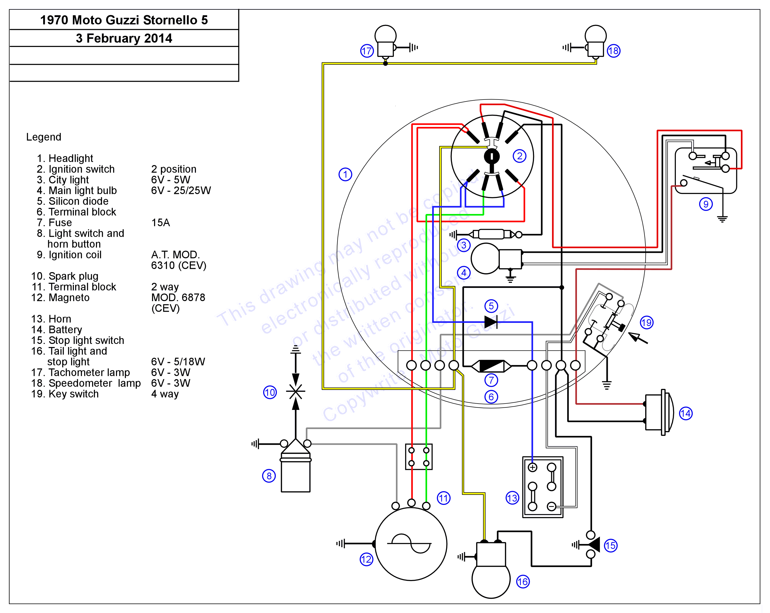

Guest Nogbad Posted June 30, 2006 Posted June 30, 2006 jrt said: Too cool! If the wiring is completely shot, brittle and oxidized, just go ahead and make a new loom. It's really not hard (maybe 6, 8 wires). You could download one of the loopframe 'simplifed' wiring diagrams and adapt that to your bike if necessary. 93633[/snapback] There IS no wiring. Someone has somehow wired the genny to the coil to make it run without a battery, unless it always had an "energy transfer" type ignition like a lawnmower with separate coils for generating power for the ancillaries. Can anyone tell me?
callison Posted June 30, 2006 Posted June 30, 2006 What an opportunity! Fix the wiring and upgrade it. Rec-Ignition Module
mike wilson Posted June 30, 2006 Posted June 30, 2006 Nogbad said: There IS no wiring. Someone has somehow wired the genny to the coil to make it run without a battery, unless it always had an "energy transfer" type ignition like a lawnmower with separate coils for generating power for the ancillaries. Can anyone tell me? 93657[/snapback] You lazy boy! 8-))) http://www.thisoldtractor.com/guzzi007/sch...llo_125-160.gif
Guest Nogbad Posted June 30, 2006 Posted June 30, 2006 mike wilson said: You lazy boy! 8-)))http://www.thisoldtractor.com/guzzi007/sch...llo_125-160.gif 93665[/snapback] Hey thanks. So it is energy transfer. No wonder the damn spark is weak. I have items 5, 6, 2, 8, 10, 12 and 16. And a headlamp shell. I need everything else! I wonder if the later bikes had indicators or not.
mike wilson Posted June 30, 2006 Posted June 30, 2006 Nogbad said: Hey thanks. So it is energy transfer. No wonder the damn spark is weak. I have items 5, 6, 2, 8, 10, 12 and 16. And a headlamp shell. I need everything else! I wonder if the later bikes had indicators or not. 93676[/snapback] Do I have to do everything around here? 8-))) http://www.thisoldtractor.com/guzzi007/sch...Stornello_5.gif Apparently not. Are you really going to give that to a 17 year old? m
mike wilson Posted June 30, 2006 Posted June 30, 2006 There's a mistake in those diagrams. 8 & 9 are transposed in the legend. Pretty obvious but I would check the rest of it, just in case. m
