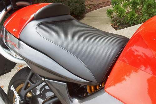

turo Posted July 8, 2006 Author Posted July 8, 2006 So here’s where I’m at so far. I have decided to take the advice of some of you and have refrained from making any ergo mod’s to my Rosso Corsa (RC) to see if I adjust. I have many questions and I apologize in advance. My history with motorcycles has always been with Honda 4’s. I bought the RC for something different, and boy did I get it! I have no past experience to gauge the Guzzi’s performance by. I have tried to find the questions to many of my questions by searching the forum, man do you guys talk a lot I always seem to come up with 50 pages of info and it’s become difficult to sort thru it all. So if some of my questions are redundant, I again apologize. If you can point me to a relevant thread – that’d be cool too. Or just answer the questions you feel of are of interest to you and I’d be grateful for that as well. 1) Seat – this is definitely something that needs improvement, I’ve decided to pursue the Rich Maund seat. One, because of the positive reviews he’s gotten on this site and Two, because I just don’t like Corbin seats. 2) Handle bars – this needs to be addressed next, just a little further back and a little up! I am concerned about rising or lowering the forks thru the triple clamps to accommodate the mod, I just don’t want to do that. We’ve got the Two Brothers Racing bars, the Williamsville version, Jean Marc’s version and the Verlicchis. Which of these DO NOT require the triple clamps or forks to be adjusted? 3) Foot pegs – This one can wait! I may not need them if the handle bar mod proves enough as I may be “adjusting”. I don’t like the look of the Buell conversion. I’m deciding between the MotoBits/Evoluzione mod, which looks good and I understand that I’ll get better comfort plus tunable shifting and brake action and the Centauro mod which I think looks even better. I’ve read the MotoBits mod maybe a challenge for non large footed people (I’m a size 10). Any feedback? 4) The headlight works OK, but I want MORE! I understand that Greg Field has access to a relay kit to increase the light – anybody use this? Other suggestions? What about the Night Cutters by Saeng? Is there a way to have the high beam and low beams on at the same time? Will the circuit be able to handle it? Is there a better aftermarket headlight? 5) I’m working on the 5 relays for under the seat and a dry cell battery. I don’t know why, you guys just keep telling me to As a 2003 model, do I need the new relays? 6) Some “performance” questions! - When I pull the clutch in while idling at a light, it’s rattles a bit, is this normal? - I seem to get a bit of “drive line lash” when I shift from 1st to 2nd, just a bit from 2nd to 3rd, none after that. I originally thought it was the transmission taking a bit of time to engage – but I believe I’m wrong and it’s drive line lash with the shaft drive. I ALSO THINK it’s because the idle is a bit low, around 800 rpms. The problem seems to go away when I use the choke to keep the idle up. Any feedback? 7) The bike is pure joy to ride from 40 to 60 mph. It’s great for tooling around the back roads of New England. I took it out on the highway yesterday and while it was fun, the bike seems to be working hard at 85 miles per hour, the fastest I’ve gone. I guess I was afraid to go faster. The bike obviously goes faster that that. Someone please tell me what my experience should be at that speed or higher! What’s this PClll thingy. 8) When I turn the handle bars far to the left the forks bang up against the steering damper, is this right? 9) I will pick up the longer Buell mirrors. 10) Anybody put an oil temp gauge on this sucker? 11) The faqs page suggests that the tank suck issue on a 2003 shouldn’t be an issue, but man when I opened the gas tank yesterday after using half a tank of gas, boy did that tank expand. I was actually quite surprised by how much the tank expanded when open. Is this bad? What’s the fix short of removing the cap gasket? 12) Thanks everyone!!! When are we going riding?
