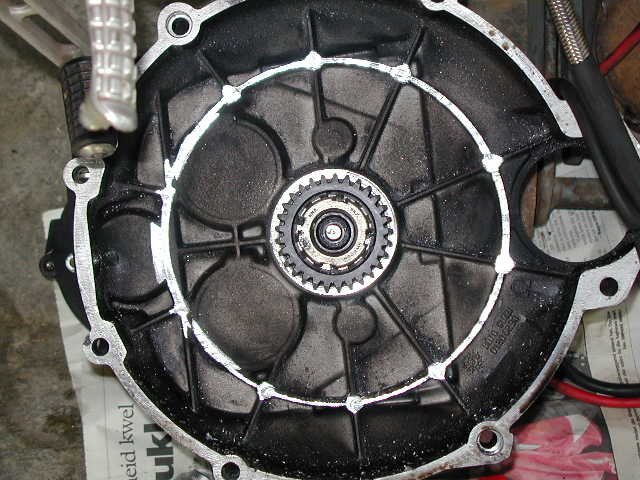

guido Posted July 21, 2006 Author Posted July 21, 2006 Now it is apart. this is what I found. No bolt is loose, Whole plate seems to be too far back from engine. I will study closer now, any ideas? The silver circle is where three bolts from the flywheel have touched the box
mike wilson Posted July 21, 2006 Posted July 21, 2006 Now it is apart. this is what I found. No bolt is loose, Whole plate seems to be too far back from engine. I will study closer now, any ideas? The silver circle is where three bolts from the flywheel have touched the box Looks like you might have a broken crank. Especially if the clutch has been so "wobbly" as for only three bolt heads to be touching. If you're lucky, it's not that. Slightly less lucky and it's broken at the journal, so only the crank needs replacing. Very unlucky means that it's broken at a web and puched the back wall of the case out. Fingers crossed. m
guido Posted July 21, 2006 Author Posted July 21, 2006 Put the allen key to the bols.they were ALL loose. Seems as if the guy who had it apart did not have an alignment tool and left the stuff loose to align the plates. Forgot to tighten. Voila. Very little damage done as far as I can tell.
