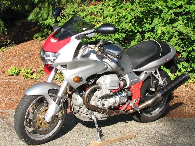

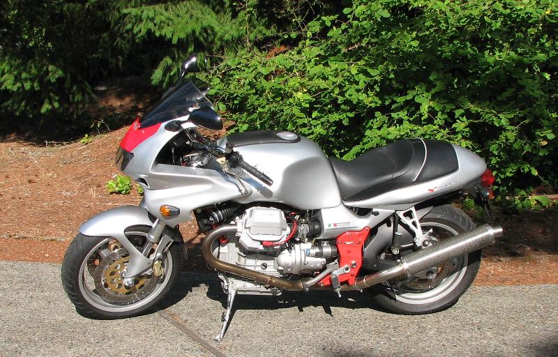

RonV11 Posted August 1, 2006 Posted August 1, 2006 Leftover fairing from my Superhawk Streetfighter Project and obviously to much time on my hands... Result a 2000 Moto Guzzi V11 SuperSport... (The Super comes from the Superhawk). This configuration works very well. More wind protection and slightly lighter steering with the fork mounted bikini faring removed.
Keith Foster Posted August 1, 2006 Posted August 1, 2006 Leftover fairing from my Superhawk Streetfighter Project and obviously to much time on my hands... Nice job, good color match too. How about a front on shot?
RonV11 Posted August 1, 2006 Author Posted August 1, 2006 Nice job, good color match too. How about a front on shot? Thanks... Here you go... A front and a front 3/4...
beauchemin Posted August 1, 2006 Posted August 1, 2006 That is THE best looking add-on fairing that I've seen on any V11. Nicely done!
DeBenGuzzi Posted August 1, 2006 Posted August 1, 2006 Kudos, looks like it belongs there. I think I've seen V11's with Aprilia fairings and thats a lil better considering they were at least staying italian. But a very nice looking Mut you got there.
stogieBill Posted August 1, 2006 Posted August 1, 2006 And...you've got a real headlight too! Nicely done!
gthyni Posted August 11, 2006 Posted August 11, 2006 I been thinking about trying out a CBR600 crash fairing on my V11 so I'm interested in a shot of the frame mounting solution. any chance of a snapshot of the inside?
waspp Posted August 12, 2006 Posted August 12, 2006 That really is sharp! Youv'e done a good thing there, that fairing looks like it came on that sport. Nice work! waspp
