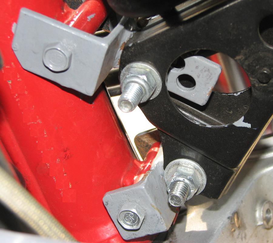

RonV11 Posted August 12, 2006 Author Posted August 12, 2006 Is that an intake tube sticking just below the tank and behind the oil cooler? Yes... I used flexible rubber radiator hose of the diameter that allows the hose to slide over the airbox intakes. The original clamp holds everything in place. Plastic zip ties hold the front of the hose in place against the frame. I don't think that it makes a performance improvement. Though, it does not "ping" under load at low RPM as much as it used to. Seems that cooler air would be better for the engine anyway.
RonV11 Posted September 8, 2006 Author Posted September 8, 2006 Sorry for the delay... Here's some detail of the installation. Not pretty but it works...

BrianG Posted September 16, 2006 Posted September 16, 2006 Sorry for the delay... Here's some detail of the installation. Not pretty but it works... Very nice work! I'll be stealing this idea for my Adventure-touring RC-51 project!
