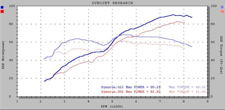

al_roethlisberger Posted March 17, 2023 Posted March 17, 2023 These are very dated, circa 2002/2003, but still interesting, and phenomenal results: Quote HP went from 83 to 90.3 at the rear wheel Torque went from 61.4 to 68.3! guzzipower.com - John T's Rippin' Rosso guzzipower.com - John T's Rippin' Rosso Pt. II 2
