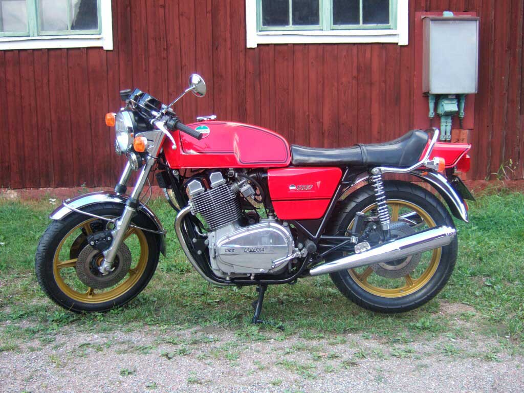

mdude Posted August 31, 2006 Posted August 31, 2006 Some of you old salty sea beards have probably some experience with Laverdas biggest and toughest. I have always lusted for a Laverda triple; 1000, 3C, 1200 or Jota. Now I have suddenly come across two interesting subjects: one Jota 79 (oooh soooo sexy!!) and one 3C 77 with Jota-specs. Very nicely priced, and both appears to be well sorted and fit to roam. The Jota has some battle scars, but nothing serious. The 3C appears to be mint. Both are priced to sell. I have never ridden one, because they are so rare. What should I expect? I've read volumes about the Jotas rock hard suspension, earbleedingly loud engine and heavy clutch and all that. I can handle that. I'm a big boy now. And thats why I want one. I'm also familiar with the need for fiddling; I've got a V11 and a Laverda already for chrissakes. But can anyone tell me: when compared to the V11 (which is a classic/veteran at heart) how is it like to drive? Does it handle? Can you trust it on longer trips? (assuming that the niggles have been fixed already) What should I especially be lookin for? Is it a stable and sporty touring monstre like the V11? Give me advice, please (I f... hate msn-groups, thats why I ask on these pages)

Baldini Posted September 1, 2006 Posted September 1, 2006 mdude said: ... The Jota has some battle scars, but nothing serious. The 3C appears to be mint..... I never had one, but impressions of a couple of brief rides were a really lovely, creamy, smooth & powerful motor (let down by terrible on/off advance/retard stutter at lower revs - as others mention), a very tall, roomy riding position, but unlike Steve, I found handling wasn't very confidence inspiring, but maybe you get used to it - he's a longterm owner so should know best. As I recall they'll drag the alternator casing ridden hard & if they go down on that (righthand?) side can damage the crank...so maybe check for any evidence. A V11 is not so roomy, not so smooth a motor (apart from ign stutter). Longterm & used hard a sorted & cared for Guzzi is v solid. I haven't enough experience on the Laverda to know but my impression has been that the Laverda is more fragile, despite it's appearance of being hewn from solid. And I'm surprised Steve finds handling & stability so much superior to the V11 (unless he's simply comparing shaft/chain driven character?) - perhaps it depends on specific bike? Laverdas have a real presence & a lovely wail - it's the motor that makes them tho. KB

Steve G. Posted September 2, 2006 Posted September 2, 2006 Looking at the pictures, there are things I don't care for with the Jota. The big one for me is the fact there's no air filter, just those silly bell-mouths. These engines are just like any other, the ingestion of dust means an early wearing out. Plus, the air box may be expensive to buy a new one. Another thing I don't care for with the Jota is that dent on the frame right side down tube, near the top. I personally would not buy this machine. It has an unkept aura about it. The 3C appears, except for the shagged seat, to be in way nicer shape, and because it hasn't had to carry the distinction of being a Jota, has probably enjoyed owners with greater mechanical sympathy. The 3C would be a much more enjoyable of the two. A true Jota wants high octane as well. Buy a new seat and put on some Jota mufflers and it will make all the right sounds, believe it. With regard to the handling of the Laverda, certainly getting new shocks would be the first order of the day. Laverda parts/supply legend Wolfgang Haerter is the North American rep for the new Koni shacks, re-named Ikon. 'Very' good prices. As well, worn swingarm bearings can send these into the dreaded rear end wobble if you hit a bump mid corner. New ones change this. I would agree Baldini that the Moto Guzzi engine is truly made of granite, very tough, but as has been the case for it seems decades, Guzzi has sourced componentry sometimes based on price rather than quality. I would not consider a Moto Guzzi motorcycle, as a whole, especially a V11 based machine, to be as rugged as a Breganze Laverda. When I mentioned the handling characteristics of these two machines, I think I mentioned the stabilty of a Laverda as much above average, but I did note that it's nimbleness was not on a par with the V11. Ciao, Steve G.

mdude Posted September 6, 2006 Author Posted September 6, 2006 again, guys. thanks for all the shared experience. it helped a lot. I'm currently negotiating with the owner of the 3C (and my wife...). It has been Jota-fied somewhere along its history, apparently. With new pistons, cams and exhaust. All original parts comes with the bike. Despite the specs he describes it as very smooth and driveable. The current owner rebuilt it two years ago with a huge amount of new rubber and fittings, blasted/powdercoated frame and all. He is asking 4750 euros for it, but we'll see. (its not a bad price, considering its in expensive Scandinavia)
