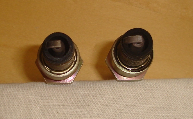

al_roethlisberger Posted September 10, 2006 Posted September 10, 2006 Well, after the move to NC last Summer, believe it or not, I have *just* now gotten around to a lengthy ride on the bike when a friend rode over from Texas this weekend. I have lots of excuses why I haven't been riding this year(and I swear, some are GOOD ONES ), but let's just leave it at that So anyway, here are my observations and questions: First, as you may recall, last year the bike got its defective fuzzy cases swapped, and at the same time in went a Megacycle cam and MR pistons. The bike now runs like "stink" as Pete would say, and has never idled or generally run so well. So that's good news. It also starts right up every time, with no fiddling of any kind But after riding about 200 miles yesterday, I noticed that between 3-5k(mostly), on constant partial throttle(maybe 20%?) after a few seconds, the bike wanted to pop out of the exhaust. This popping was just like the pops/report you hear from the exhaust of many race bikes and the come off WOT into a curve or down a cork-screw. And it wasn't just audible, it often could be felt, almost like "miss", but I don't think it was missing per se. Now, this wasn't constant, and could be managed with some variance in throttle position. But it was quite annoying when going through towns where the speed limit was 35-45mph, and the bike just didn't seem happy once good and warmed up(about 90 degrees F). Now, the bike has always hated to run at that 3-4k RPM range, even before the mods, and as we all know, that is a little low on the RPM range anyway, so I do avoid it. But every so often, you just get stuck there for a bit, and don't want to wind the engine out to go 30 mph So, I'd like to get some ideas on why I am getting this popping/backfire thing on constant partial throttle in this RPM range. And BTW, it does it a bit over 5k RPM every so often, just not as much.... kinda rare actually. I have also attached a photo of my plugs following the ride, right and left respectively. I think they look a tad rich, but still well within "OK". See if those add any clues. I will say my exhausts seemed a bit dirtier following the ride, so maybe a bit rich? Other than this one issue, the bike ran like a champ. Thoughts? Al
dlaing Posted September 10, 2006 Posted September 10, 2006 This type of popping can usually be fixed by adding fuel to the appropriate map area.... But it seems like you are already running rich. Have you dynotuned with tuning link? A nice even lambda should keep it from getting too hot, but also help reduce carbon build up.

dlaing Posted September 11, 2006 Posted September 11, 2006 the stacks could be making it just enough richer to make it pop. Tuning the PCIII is a piece of cake....just requires a little patience and subtle changes.
quazi-moto Posted September 11, 2006 Posted September 11, 2006 A tuner/mechanic guy I met at a dealership told me that doing plug chops with today's fuel and fuel systems really doesn't tell you much. I don't know myself how much truth is in that, but he tried to fatten up the map on my PCIII to get rid of the mid-range popping that Al described and it just seemed to make the overall map too rich yet it still popped at part throttle/mid-RPM's. I'm now running with the My15M and putting it through its paces. I'm going through some growing pains, but I feel optimistic that I can get it just about spot on with some more tweaking and I'm only running open loop for now. On a street ridden machine the mid-range performance is crucial. At least it is to me anyway. With the amount of torque that this bike has it seems rather ridiculous to have to keep the engine spinning above 4000 RPM all the time. These bikes have the potential to be great road machines, but the fuel management issues are a nuisance.
