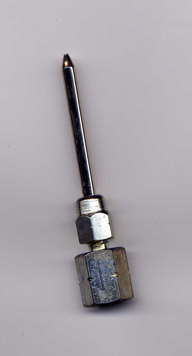

belfastguzzi Posted October 10, 2006 Share Posted October 10, 2006 I'm going to try the Manitou fork lift grease gun attachment first - I've located a dealer in the UK so I'll give them a call tomorrow and let you know how I get on Can you post a picture, if you get one? Link to comment Share on other sites More sharing options...

Tim Posted October 14, 2006 Author Share Posted October 14, 2006 I've tracked down the grease gun attachement for a Manitou fork lift truck - it's quite expensive at £18.44 + VAT (about £22 in all) but what the hell - if it works it will be worth it. I'm ordering it this week and I'll let you know how I get on with it once it arrives - Belfastguzzi wanted a picture which I'll sort out when I get it Link to comment Share on other sites More sharing options...

Tim Posted October 20, 2006 Author Share Posted October 20, 2006 Hi Folks - the Manitou fork lift truck grease gun attachemnt arrived - don't get too excited it's basically an oversized hypodermic needle but if it works it will be worth it I've attached a pictue for Belfastguzzi's benefit - however I won't be able to tell you whether it works as I'm on holiday for a few days.... Link to comment Share on other sites More sharing options...
