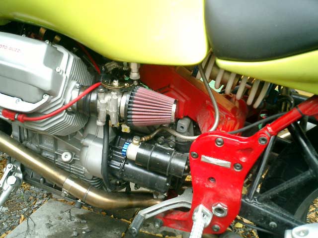

gthyni Posted September 20, 2003 Posted September 20, 2003 At last the pods is in place, some plastic also got lost Filters are K&N RC-1200
Guest John T Posted September 20, 2003 Posted September 20, 2003 Nice! I thought these needed to be placed not directly to the TB but to a short piece of intake runner?
al_roethlisberger Posted September 22, 2003 Author Posted September 22, 2003 Quote Nice! I thought these needed to be placed not directly to the TB but to a short piece of intake runner? Indeed, I had always heard the same admonishment as well, but I've seen several bikes, usually in Europe, with these small cone-shaped K&Ns fixed... and haven't heard of any major problems. Perhaps this "it requires runners" advice is a bit of "urban legendry" ?? I have no idea. But, interestingly, the K&Ns I used in the photo below, and that I've seen on many V11 Sports... includes this runner by it's design, and they are ribbed inside to grip our TB opening... and angled such that you can tuck the filters up inside and against the frame. I think these are made specifically for this application, or at least practically... they work as if they are. And it's a very large filter, with lots of surface area It could probably only be "better" if the end-cap was also filter material As it is, only the the cylinder itself is filter, and the end-cap is solid rubber. However, I doubt that makes much difference. I would guesstimate that each K&N is roughly the same surface-area as the individual OEM flat filter, or darned close. They are that large. The part number is: RU 1780 Here is my previous post summarizing this info: al_roethlisberger said: Hi Rudy, Well the pods I have are the newer models that have the "intake runner" already integral to the pod, as opposed to older pods that were simply cannister/cylinders that clamped onto the intake. These filters have a about a 4 inch "runner" already molded into the filter, and have the runner angled such that the filter can be appropriately angled and adjusted to fit correctly by simply rotating the filter around. The part number is: RU 1780 Very nice, but pricey, filter. I'll be fine-tuning and cleaning-up the installation tonight and tomorrow, and then I'll post some final photos. I think that for what I'm looking for, this will work very well. I was surprised how well it turned out if you want to know the truth ...after all, it was just a "weekend hack project" that I was pretty sure would just end up being a mess, and I'd go back to my stock airbox with no lid al ....BTW, when it was all said-and-done, I still have no idea if installing the pods versus just using an "airbox lid eliminator" kit offers more or what kind(Torque vs HP) gains. At some point it would be a great test for someone to take a bike and put both solutions on(only takes a few minutes to swap out and test) and put it on a dyno and see the results. I think that would be very enlightening. Personally though, even though I still have the side-covers, removing the airbox and freeing up all that room under the tank and around the frame was a real advantage. At the very least it was much easier to groom the cables/hoses, and work in that space without the box... and I'm convinced it has to have helped thermally... letting air circulate better with it gone. Even with my side-covers still in place(the removal of which is a big plus for pods in many people's opinion), it still looks a lot more open and "clean" in that area IMHO So even if one day keeping the air-box with a lid-eliminator is shown to produce more power, I'm very happy with my hack-job Maybe someone with a dyno and some free time can try this experiment one day? I'd think it would be to FBF's advantage to take a bike and do so since they sell a kit. Again, it would be a simple afternoon task. al

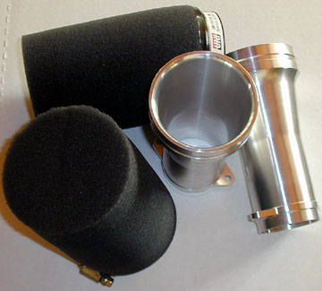

al_roethlisberger Posted October 24, 2003 Author Posted October 24, 2003 For those installing pod filters, especially the smaller ones, check out these aftermarket "velocity tubes": Sport Cycle Pacific Velocity Tubes ...pretty pricey, and not 100% sure if they'd bolt on to the V11 throttle bodies, but looks interesting al
