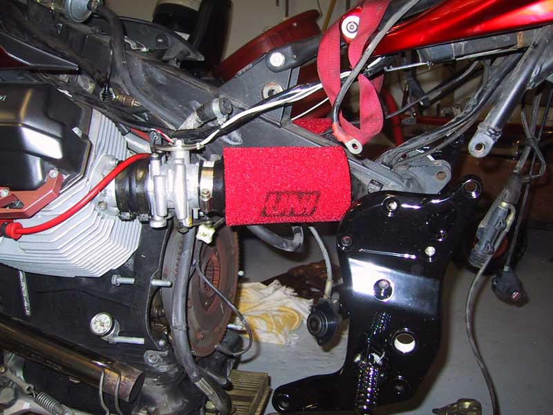

andy york Posted February 24, 2005 Posted February 24, 2005 Or you can go with this ... UNI UP-6200AST 2 stage pod angled 16.95 ea andy
richard100t Posted February 24, 2005 Posted February 24, 2005 andy york said: Or you can go with this ... UNI UP-6200AST 2 stage pod angled 16.95 ea andy 44367[/snapback] Wow :!: What are you doing to that poor bike? lol You didnt have one of those crappy flywheel/clutches did you? I like the price of that filter you have, but I think the K&N looks way cool & thats what I'm after. I was going to get a Hayabusa before I picked up my RM. The bike has good enough power, but I like it for the style & handmade exclusivity.
