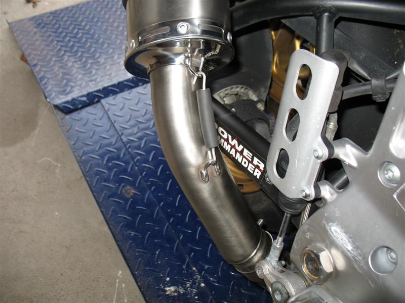

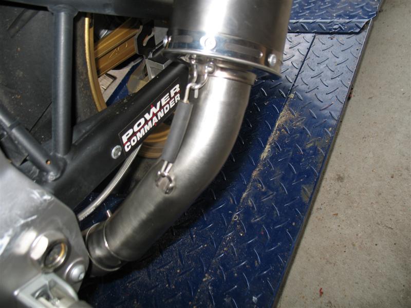

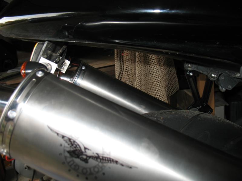

A few weeks ago Luhbo made me an offer I couldn't refuse; I bought his Guzzi Ti racing kit. Today I finally found time to mount it. No problem, but I can't get the two mufflers parallel.
I have used the brackets that came along with the set. Only thing I can think off that could cause problems is the Mistral X-over.
My question: did I do it correctly? I attached I few pics, so you can figure out how I did it.

We've put on dozen of these sets, and each one ends up being slightly different in position than every other installation.
Keep all the clamps loose while fitting and adjusting position of the mufflers. Twist the inlet pipes one direction and then wiggle the mufflers to try and get them to settle where your eye tells you is the right position. This is difficult to judge because the main points of reference (passenger-peg brackets and swingarm) are not parallel or symmetrical. You can even try reversing the position of the band-type muffler hangers or sliding them foreward or aftward on the muffler to subtley change position of the mufflers.
In general, try to move each muffler through the above means until each muffler is as close to the centerline of the bike as it will go. Then do fine adjustment for symmetry after that.

Don't measure how they look from the side but look at them from the back side to notice differences.
If there is happening that with other exausts may not be at the same height then perhaps you don't have to
worry. Besides when you ride you don't look at the exausts if they are side to side OK , you listen to the sound and you enjoy the performance. ;)
Mine are not in the same height , have you noticed it?.Even though my bike hangs on the official guzzi site. B)

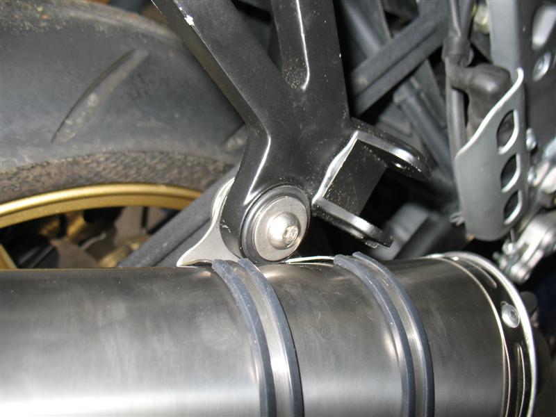

You have the bands very close to the front of the cans. With some fiddling they can be mounted a little further back to give slightly better suport.

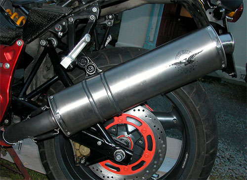

Old picture here
from old post
I also lowered these a bit, so that they were away from the indicator lights that I fitted
