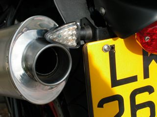

luhbo Posted October 24, 2006 Posted October 24, 2006 Startwin. I have no clue either why the original pipes are so wide running, I once made some connecting pipes for a set Bos silencers, an got them running parallel and narrow, on a stucci crossover. Paul and Jaap on the picture Paul posted the cans don't look symmetrical nor parallel, albeit it's not the worst look at all. The Titaniums should come out very tight below the rear end of the seat, nearly interfering with the indicators. Then they look good. Actually some copied this look for the back of the Aprilias. At home I have a picture from Jaap's meeting in 2004. One dutch fellow had them attached perfectly, on a green short frame V11. Wait a bit and you'll see what is possible. BTW, actually I'd not use tape to protect them, as I've written. Now I think a good solution would be the use of a piece of a inner tube, strapped over the cans where the clamps are. If everything fits you can mark the clamps and cut the rest off. This would also further improve the fitting and the problem with getting them tight. Hubert
belfastguzzi Posted October 24, 2006 Posted October 24, 2006 on the picture Paul posted the cans don't look symmetrical nor parallel, albeit it's not the worst look at all. The Titaniums should come out very tight below the rear end of the seat, nearly interfering with the indicators. Then they look good. Actually some copied this look for the back of the Aprilias. That's too high, with aftermarket indicators, which is why I lowered mine
