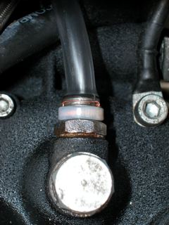

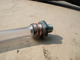

slug Posted October 23, 2006 Posted October 23, 2006 If the oil was milky looking it's because it's got water in it so it's formed a mayonaise. This is a particular problem on V11's, especially those regularly ridden in the rain, because the gearbox breather is directly in line with the spray from the rear tyre. To be honest it wasn't the Guzzi design shop's finest hour To prevent a reccurence of the problem it's possible to make a *shield* out of something, (It doesn't have to be as hideous as Greg's whiskey fueled inner-tube offering in the Bodge thread but that'll work fine ) A piece of perspex cut to fit in the triangular part of the shock cantilever brace and drilled so it can be retained by cable ties seems to be the commonest form I've seen but I haven't seen a lot of them so someone else will almost certainly have a better idea. Instead of a shield, I removed the vent plug from the gearbox, lopped the cheesy little cap off and soldered in a small piece of 1/4" copper tube bent at 90 degrees. Put the plug back in, attached some rubber hose to the copper tube and ran the other end up underneath the seat where I knew spray wouldn't work its way in. Haven't had the pea soup/frothy pink in my gearbox since... I'd post pics if my digital camera wasn't such a hunk o' s**t.

belfastguzzi Posted October 23, 2006 Posted October 23, 2006 Instead of a shield, I removed the vent plug from the gearbox, lopped the cheesy little cap off and soldered in a small piece of 1/4" copper tube bent at 90 degrees. Put the plug back in, attached some rubber hose to the copper tube and ran the other end up underneath the seat where I knew spray wouldn't work its way in. Haven't had the pea soup/frothy pink in my gearbox since... I'd post pics if my digital camera wasn't such a hunk o' s**t. The inner tube shield is pretty much an essential anyway (and at no cost) as it keeps crud off bits like the rear shock. I also put an extended breather tube up to under the seat, but didn't solder in a copper tube. Just take the cap off and wire on a hose. Belt and braces.
