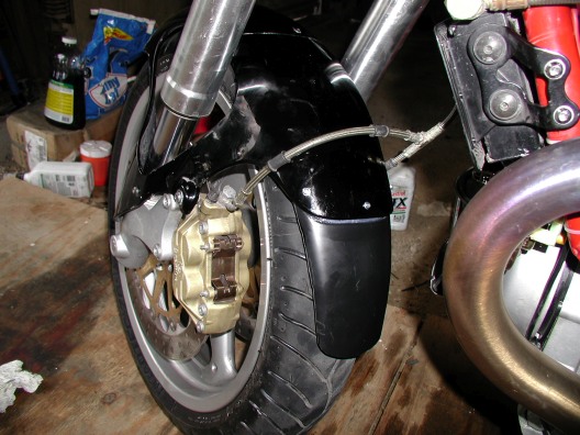

jrt Posted November 14, 2006 Share Posted November 14, 2006 Do a search for "fenda extenda". This has come up before. I did this awhile back...couple years ago, I guess. They work great, and this mod really does help keep the front of the engine cleaner. I do have to admit- yours looks like a nicer job- These pics were taken as I was installing it- I've cleaned up the edges a bit more now....yours still is nicer. For the fork tubes, one cheap fix that I've seen is to cut a rectangle ~2 X 3" out of a 2 L coke bottle (or whatever soda you drink). Tape or otherwise affix it to the front side of the fork sliders and it protects the tubes. Use a clear bottle and no-one can see it. Link to comment Share on other sites More sharing options...
