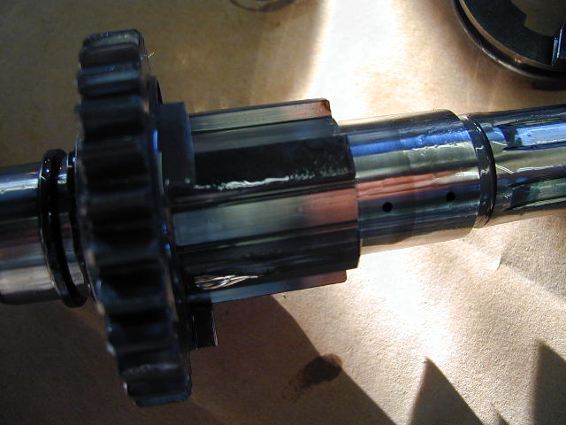

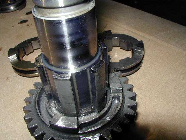

Just on the odd chance he was right, check your box. I might well have had a similar experience. This is what I found when I took the box to pieces.6Y200132.jpg6Y200133.jpg
In case you can't see, there is a pick up from 4 of the six flanges on the secondary lower shaft on to the sixth gear. Look carefully at the top of the flange, you can see a blue area where the thing has got awfully hot. That means, as far as I can tell, when driving in sixth, the gear follows the shaft rotation, when I geared down to fifth, sixth and fifth would have been engaged simultaniously because 6th gear (which then should rotate freely against the flanges) welded itself to the flanges for a split second, until the dog (which you see at the bottom of the shaft), which is far more substantial than the fused together parts, would rip the gear free again. Shifting a gear lower is typically what you do when entering a corner or slowing down, to keep the engine on the cam, and sudden unexpected braking in these conditions can be seriously unpleasent.
I felt a roughness for a split second before I went down, and I didn't know what hit me. I still don't, but I am starting to believe this could explain a lot. After the accident we tried the box, and it was free, so it was not suspected as having contributed to the accident. I only found the problem because I wanted to change the shift rings (mandatory recall) recently, 2 years after the event. I would never have known, had I not opened the box. I don't know the cure yet, as my dealer has taken the shaft to Italy and MG, but I should know more soon. The bike has 1100km on the clock.

Saying the rear brake locked up was a good thing to tell his wife, friends and his ego.
I don't want to alarm you, but you should know.
Apart from that, I have also had a rear brake seize on me, but that came more gradually and felt almost like the bike was running out of petrol, and it happened in a straight line on the highway. That was a test bike (V11) , where the free play on the brake pedal was insufficient, and the brake pads were dragging slightly, not enough to be noticeable at first. As the components got gradually hotter and expanded, the thing fairly rapidly, but, in this case not dangerously so, started to seize. However had it happened in a corner or on gravel, it might well have been worse. Adjusting the freeplay, cured that one quickly.
Lastly, there seem to have been other people with other experiences with both bearings and rear brakes, so I would, - just to feel better-, give them a very careful check.
