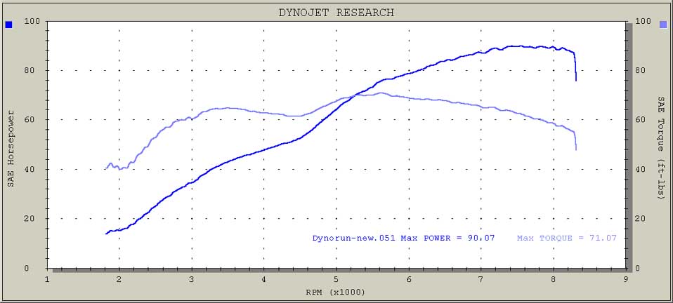

  I wanted more power but also wanted a very well behaved engine. In other words, I was looking for the ultimate Guzzi street motor. I think I finally found it. The Megacycle 620X9 cam is a direct drop in Cam with no other modifications needed to the valve train except for stiffer valve springs to help with the more radical cam lobes. As you can see by the graph there is no downside to this cam at all. (I will have todd do an overlay of the two soon) More hp at all revs and torque is much improved. This engine just pounds out the thrust when you crack the throttle. There are no more flat spots and the engine does not need to be revved to hell to get the power. The cam along with the Carrillo rods and the much needed lightening and balancing make this a very snappy revving Guzzi! I'm sure you could get more peak hp out of a Guzzi two valver, but then the trade offs for the street would be too much for me.
So, no more peak hp than before (90.3) but more hp and torque (71) all over, very noticable.

I could not wait to see how your three dyno runs compared so I overlayed them with photoshop. The torque increase is indeed quite impressive in run number 3 (in green here).

Hey! Are these numbers fudged?!?!
At 3500RPMs the torque number difference between run2 and run3 is great, but not the HP numbers.
Was the dyno operator smoking something? :rasta:
Or maybe it has something to do with the true difference between torque and HP?
While we are wondering about the smoking habits of the dyno operator I'll add that the torque and HP runs in green do not cross are 5250 RPM. Given that the formula for HP is Torque X RPM / 5250 these curves can not cross at nearly 6K RPM as shown.

Easy there folks, no fudge around here.
When you get the results they are printed on two different graphs for easy reading when you overlay a lot of runs. The scale is at a different starting point on the HP and torque page. If you read them both starting at zero, they do indeed cross at 5250 rpm.
I'll try to get an overlay that reflects this.

Here is the last dyno run with the torque and hp as they should be.
That's more like it.
