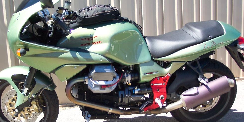

FASTFREDDY Posted November 17, 2008 Posted November 17, 2008 Being as cheap as I am, i modified my stock mufflers. Shortened about six inches, straight thru glass packed design. Great sound at a very low price. And still looks stock, which I like.
Skeeve Posted November 17, 2008 Posted November 17, 2008 Being as cheap as I am, i modified my stock mufflers. Shortened about six inches, straight thru glass packed design. Great sound at a very low price. And still looks stock, which I like. Interesting that you shortened the stock cans 6" (15cm for our metric friends), as the Staintunes are about that much shorter than the stock cans... Is that a custom paint job on your LeMans? I've never heard of Guzzi offering them in mint green?..
ponti_33609 Posted November 17, 2008 Posted November 17, 2008 Interesting that you shortened the stock cans 6" (15cm for our metric friends), as the Staintunes are about that much shorter than the stock cans... Wow, nice job.....any pic's of in-process? Was it difficult? Bob
FASTFREDDY Posted November 18, 2008 Posted November 18, 2008 Wish I woulda taken in progress pics. Alas I did not. It's not hard to do, just very time consuming. I've done two sets so far. I slide the cover off, cut the ends off, drill spotwelds out, split the case down the seam, remove guts, reweld seam, weld front cap, fabricate perforated tube, install tube, pack, weld back end cap on, trim cover to fit, bore out hole in decorative endcap, and voila!, done. The color is off the custom BASF color chart called Peridot. The pictures don't do it justice. BTW, this is by far the best bike I have ever owned in 34 years of riding.
