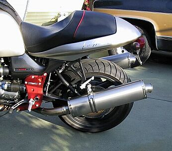

al_roethlisberger Posted June 23, 2003 Posted June 23, 2003 BTW, here is the link to the forum discussion about installing the Leo Vince pipes, and several photos of the Ti Oval pipes installed on my LeMans: Leo Vince Bushing Question Thread Here is one quick photo... al
Guest Jaap Posted June 24, 2003 Posted June 24, 2003 I really like the look of that Ti "rack"... I wonder how they sound.
al_roethlisberger Posted June 24, 2003 Posted June 24, 2003 Jaap said: I really like the look of that Ti "rack"... I wonder how they sound. ...well, it's hard to describe, but I suspect it's not a lot different from any of the other exhausts from FBF, Mistral, etc. It's quite low, "burbling", and a bit louder than I expected, but not offensive. I think it sounds very good. ...although in combination with the pods, my GF asked yesterday, "I thought you didn't like loud bikes?? " I tell ya though, when it was on the dyno and the guy was revving it up, standing behind it certainly got one's attention al

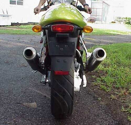

al_roethlisberger Posted July 18, 2003 Posted July 18, 2003 ...so here's and updated, update Attached is a photo from a '00 Sport that was on eBay. From the rear shot, one can clearly see that the right exhaust hangar is "kicked out" just as it is on my '02 as I've reported. Now, from the photo it is impossible to tell how far the hangar on the '00 is "kicked out" over the left, or if it's equivalent or much less than the '02+ bikes with the 5.5-inch wheel. But it's just interesting to note, that in true Guzzi style, these things can apparently vary from bike to bike. Perhaps some pre-02 bikes do indeed also have unevenly spaced exhausts/hangars as delivered from the factory as well. Just something to consider when mounting aftermarket exhausts, and trying to "even them up". BTW, my Stucci x-over is very apparently "uneven" from the factory, so my pipes don't quite sit level. I'll bend it, but it's a bit annoying that they got such a simple thing wrong. al
Guest geezerx Posted July 19, 2003 Posted July 19, 2003 Al, my 00 V11S has that same offset. Using the tire edge as a point of reference there is approximately 1/2" more offset to the hanger on the right side than on the left. But then the right side muffler is closer to the swing arm than the left. Perhaps a little Kentucky windage trying to produce a harmonious appearance? Looks on the bike in your post that in addition to the extra offset @ the right hanger, the back end of the right muffler might be jacked out a little thus emphasizing the difference.
