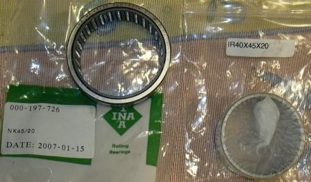

The bearings have arrived, for those that are interested, they are..
nk40/20 £23.42 +vat(this is a big needle bearing)bearing4.JPGalthough I've been sent a nk45/20 (it says 40/20 on the order) anyone know what this means ? it looks the same dimensions, although the old bearing isn't out yet !
"I 12/16" (Pinion nose bearing) not a 12/16 (the I means it has an internal race and this makes the whole bearing bigger)
still can't get that pinion nut off though :bbblll:
nk12/16 £11.72 +vat (pinion nose bearing) but this doesn't have the inner race so I may need to buy that elsewhere ? (hopefully Rossoandy remembers what he did ).
