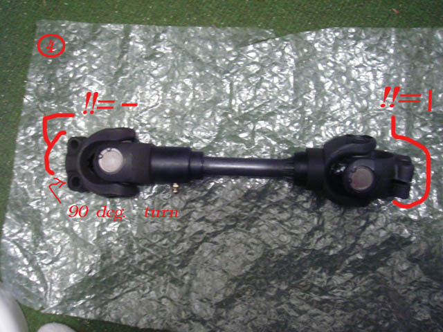

Alex-Corsa Posted February 4, 2007 Share Posted February 4, 2007 For this reason it is important to make sure that the trunnions line up like so +------------+ Not like so x-------------+ V11's have the paint marks to help. On earlier machines I believe one relies on the grease nipples being in line or simply guaging everything up by eye. Pete Thanks Pete for your time and explanation. To make the long story short (as far as I understood) at the pic. I posted the 2 pos. the shaft is alligned, right? never noticed that in my Guzzi, will have to look tomorrow. Link to comment Share on other sites More sharing options...
Alex-Corsa Posted February 5, 2007 Share Posted February 5, 2007 For this reason it is important to make sure that the trunnions line up like so +------------+ Not like so x-------------+ Pete Have checked my bike an the allignment is like so +---------+ Thanks Pete Link to comment Share on other sites More sharing options...

Guest ratchethack Posted February 5, 2007 Share Posted February 5, 2007 Wait a minute, re-reading the whole thread makes me hoping that 45 degrees would be worst case... is that right Pete? Well, Pete had his say and I had mine. Now who y'gonna b'lieve. Er, hold on. Scratch that. OK, think of it this way: Here we have the marks aligned: +--------+ Here we have the marks 180 degrees to each other. See the resemblance? (no functional difference from aligned): +--------+ Half-way between is worst case, +/- 90 degrees: +--------x Now here's a visual aid of correct alignment (by courtesy of Alex) to remove all doubt: Link to comment Share on other sites More sharing options...

Guest ratchethack Posted February 5, 2007 Share Posted February 5, 2007 I was actually hoping for a raging battle between the two of you Well, no... that would be 45 degrees unless my brains stopped working altogether. Not? I tried googling some but I found no definite answer. 45 degrees would be very bad, that's for sure. But I'm not too sure about 90. I will line it up anyway just because I'll take any excuse for getting oil under my nails. Raz, the x and + are 2-dimensional representations of a 3-D concept, since 2-D's all we've got to work with using alphanumeric symbols. But if you imagine a 3-D ISOMETRIC VIEW, it can represent a shift of 90 degrees. It's easier to look at Alex's photo and imagine ONE END ONLY rotated 90 degrees to the other, and you have worst case scenario. Be careful when you look at sine wave representations of U-joints. It's easy to get confused. The typical x and y-axis graph will show the sine wave of the angular velocity change through a single joint. We're talking about 2 joints and the degree of change BETWEEN THEM from perfect alignment, where the PHASE SHIFT of the sine wave of one joint exactly cancels the other. I reckon if Pete thinks about it, he'll come around to my point of view. . . . or not, but I'm still right. That's my story, and I'm stickin' to it. . . . . Hey Pete, you were the perfect Gent about it, but I wound up voluntarily (and rightfully so) eating crow on the great coefficient of heat expansion of brake fluid argument way back when. You were right and I was wrong, as I proved to my own satisfaction in the Infamous Hatchracket Laboratory with Erlinmeyer flask, pipettes, Bunsen burner, and industrial thermometer. If you recall, I'd posted my results along with concessions to y'er wealth of superior knowledge of such matters. You'll also I recall I did so with humility and apologies for doubting The Master. But if y'er gonna take me on on this one, I'm gonna hafta bring in driveshaft expertise from automotive driveshaft types who've been lining up U-joints since Hector was a pup (. . . uh, kinda like y'erself!), but I reckon y'er not gonna win this one. Link to comment Share on other sites More sharing options...
Alex-Corsa Posted February 5, 2007 Share Posted February 5, 2007 Well, Pete had his say and I had mine. Now who y'gonna b'lieve. Er, hold on. Scratch that. +--------+ Here we have the marks 180 degrees to each other. See the resemblance? (no functional difference from aligned): +--------+ Yep that"s how mine are on the bike , like in the photo though the front shaft grase nipple (gearbox side) turned exact 180deg (than on the photo), still lined up +-------+ Thanks Ratchet for complementing. Link to comment Share on other sites More sharing options...

Alex-Corsa Posted February 5, 2007 Share Posted February 5, 2007 Here is a representation I shot for you with 45deg and 90 degree(compred to the photo situation2 posted before(, turn over of the front joint. Notice the ending join holes how differently dissalign. Even thoguh only on 100% allignment is on 0 and 180degr compared to again as photo 2 of previous example is. Notice that they too create or belong to a line or "axle" hope that helps and sure ratchet can give a better description than I did. Here you go. Degrees are about the closest since there aren't many or enough teeth for the other "bone end" to be brought to 90 or 45 deg.It is made so and it seems to me they allign exct face to face only in the 0 and 180 degr. set up. Link to comment Share on other sites More sharing options...
Guest ratchethack Posted February 5, 2007 Share Posted February 5, 2007 . . . it seems to me they allign exct face to face only in the 0 and 180 degr. set up. That's the ticket, Alex -- exactly right. Superb visual aids, BTW! Many thanks! But it looks like y'er off a spine on the 90 degree shot?? EDIT: Degrees are about the closest since there aren't many or enough teeth for the other "bne end" to be brought to 90 or 45 deg.It is made so and it seems to me they allign exct face to face only in the 0 and 180 degr. set up. I b'lieve I understand now. It's a half-spline off in the photo. There aren't enough splines on your 10-spline shaft to allow 90 a degree misalignment, since 1/4 x 10 = 2.5. Nor are there the right number of splines to allow a 45 degree misalignment, since 1/8 x 10 = 1 1/4. But since the V-11's have 20 splines, there are enough splines on the V-11 shafts to allow a 90 degree misalignment, (1/4 x 20 = 5) -- but not enough splines to allow a 45 degree misalignment (1/8 x 20 = 2 1/2). Got that? Doing a Web search, I discovered that Chevrolet actually purposely misaligned their driveshafts for many years by 15 degrees in an attempt to reduce harmonics (this gets fairly complex) but finally discontinued the practice because it wasn't effective. It's an illustration that you can be off by a little without much of a negative consequence. On the V-11's, 1 spline = 9 degrees. You could be 2 splines out and probably never notice. On the pre-V-11 Sport carb & Sporti, 1 spline = 18 degrees. You could be 1 spline out and probably never notice. Again -- 90 degrees misalignment is the max danger zone, Gents! Stay far far away! Better yet, align the marks. Link to comment Share on other sites More sharing options...
raz Posted February 6, 2007 Share Posted February 6, 2007 That's the ticket, Alex -- superb visual aids. But it looks like y'er off a spine on the 90 degree shot?? EDIT: I b'lieve I understand now. It's a half-spline off in the photo. There aren't enough splines on your 10-spline shaft to allow 90 a degree misalignment, since 1/4 x 10 = 2.5. There are enough on the V-11 shafts, which have 20 splines (1/4 x 20 = 5). Got that? Doing a Web search, I discovered that Chevrolet actually purposely misaligned their driveshafts for many years by 15 degrees in an attempt to reduce harmonics (this gets really complex) but finally discontinued the practice because it wasn't effective. It's an illustration that you can be off by a little without much of a negative consequence. Yup, I just realized that. Even if 90 degrees is more or less as good as 0 degrees, my misalignment must be 72 or 108 degrees and that's in the range of Greggs. Well well. Thanks a lot Alex and Ratch. By the way Alex, of course you're right it should not be called luck, but it seems even Guzzi dealers miss on this. Anyway I had bad luck. Either it was this way when I bought it, or the jap-bike-mechanic that changed my wheel removed a little too much before sorting out how it should be done. He seemed to be an experienced guy. I was a Guzzi newbie at the time so I had no idea. One positive outcome though... could my Guzzi be an even better ride now? That must be a dream!! Link to comment Share on other sites More sharing options...
